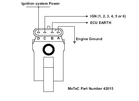

Tnx everyone for the feedback! I have already purchased the packs but Thanks for the great offers. Does anyone know the pinout on the stock version of these packs? I found this but I wanted to make sure it was right
http://www.rx7club.com/forum/attachment.php?attachmentid=210279
tnx again
Links down, anywhere else that info might be available? Below are pics of the (LS2?) coils that are going to be direct fired by a M600 MoTec ECU.

Found this http://www.motec.com.au/drawings/m32.pdf which answers one question, probably, but I'm wondering what coils I have. LS2? (see pics above)
Those coils are definitely Denso. Not certain what application, though. $20 say's the pin-outs are the same...
A Engine Ground
B Logic Ground
C Signal
D 12v
