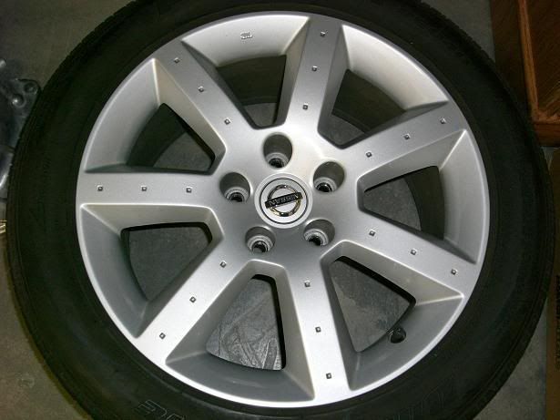

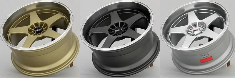

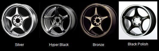

KTM-EXC Posted January 10, 2007 Share Posted January 10, 2007 First off I would like to thank everyone in advance for reading such a long post.. I just sold my 15x7 Konig Rewinds and am now looking for a bigger wheel/tire. I just wanted some different opinions on what would look good on my car. I am looking for something that is about 17x9 (I hope these will fit on the front?) Background of my car.. Suspension wise it is lowered 1 inch, but am looking into going with coilovers in the near future. Body wise it is stock other then a BRE spoiler and Xenon airdam. I am looking at 3 different wheels right now, 5Zigen FN01R-C, 17x8Front 17x9Rear. Havent decided on color though, I think bronze would look neat? My second choice would be Sport max 962's 17x9 in either gold or gunmetal with a polished lip. These are only available in a 35mm offset. I like these alot but they weight over 25lbs each! My last choice would be some 17" 350Z rims like below. They are 17.5 front and 17x8 rear. The fronts are 30mm offset and the rears are 33. It seems like I will need some type of spacer or adaptor for all of them. I have no experience with spacers or anything like that, is there any reason I should use them. I can't really seem to find a wheel that will bolt on in the size I am looking for. I still havent figured out what offset I need or even what size tire I should run. I apreciate any suggestions Thanks Rob Quote Link to comment Share on other sites More sharing options...
