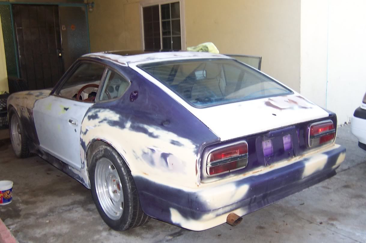

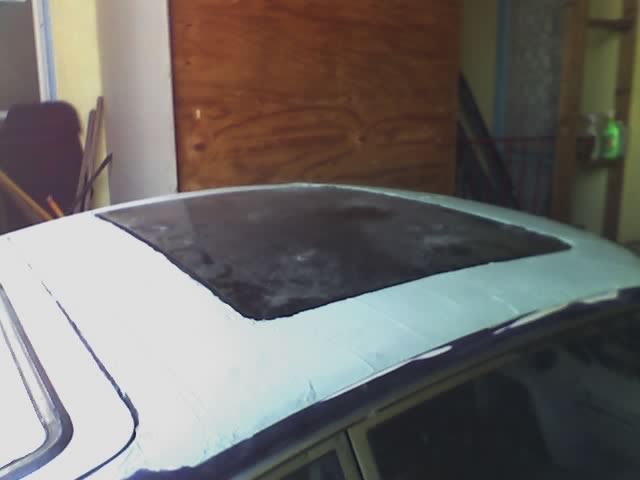

Thanh Posted July 11, 2007 Share Posted July 11, 2007 I got my car with the rx-7 generation one sunroof in it. Although I really rather not have it, it was one of my cousins wishes that I keep it when he handed it down to me. It looked like ♥♥♥♥ at first, but now that its painted, its starting to grow on me. The Nasty Heres my failed attempt to fix it. Heres the final look after I got person Quote Link to comment Share on other sites More sharing options...
TONY C Posted July 12, 2007 Share Posted July 12, 2007 looks great! is it structurally ok? has anyone got a 2nd gen rx7 sunroof installed. I am really thinking of doin it. Quote Link to comment Share on other sites More sharing options...
Two40MuscleZ Posted July 13, 2007 Share Posted July 13, 2007 it doesn't weaken anything, the roof only has structure around the sides and front, now you cut those and the car is gonna fold, but the roof itself has nothing to do with the structure of the car... I've read the posts and it comes down to either you like it or not. Now there are two destinct designs. The one that is center cut and the one that is more of the TransAm style with the cut outs above the door leaving a small center section in tact. Evildky is correct with respect to the structural support parts. In 1973 I had a sun/ moon roof installed which is larger than most and has a smoked plexy roof section that is contoured to the existing stock roof line/profile. It manually slides in and out of the anodized black aluminum frame. It also features an air deflection wing that slides into the front to deflect the air cavatation on the ears. Opens up the entire car and within 10 secs. I can button it up water tight. It does not detract from the lines or profile of the car. In most cases you don't even see it unless you are standing right next to it and it is a very clean installation. However, the company went out of business years back. But, having one in good working condition, it wouldn't take a whole lot to use it as a master and start knocking them out. I've just started my second company, MuscleZ Motorsports, and I will be featuring some custom dresser parts for the 70-73 240's to start. I should have my car on display at this years JCCS, and will kick off the business there. Currently working on a catalogue and promotional ad slicks. Anyway, I have always loved my sun roof and it has been an intrugal part of the cars accessories. Its just a matter of preference. VAN Quote Link to comment Share on other sites More sharing options...
Thanh Posted July 13, 2007 Share Posted July 13, 2007 looks great! is it structurally ok? has anyone got a 2nd gen rx7 sunroof installed. I am really thinking of doin it. Structurally its great. It just takes time to get use to you know. Quote Link to comment Share on other sites More sharing options...
