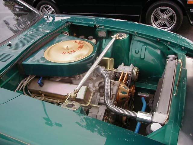

Kennysgreen280zt Posted May 28, 2007 Share Posted May 28, 2007 What are the thoughts on running the cowl panel soild, rather than having it vented like stock? The vents here, cowl panel is the best term I could come up with. Quote Link to comment Share on other sites More sharing options...
Administrators BRAAP Posted May 28, 2007 Administrators Share Posted May 28, 2007 What are the thoughts on running the cowl panel soild, rather than having it vented like stock? The vents here, cowl panel is the best term I could come up with. For a street car, I think that would be bad. That is where the “fresh” cabin air comes from. I’ve often thought about ducting the V-8 intake air into that cowl space as picture below, for a couple reasons. One being it is supposed to be a high pressure region, i.e. natural supercharging at speed. Though I don’t think it will yield much more power, or enough that we’d ever notice, but it would be a source for cleaner air, and for those of us that like the sound of the induction system, we would get that more of that as well. Quote Link to comment Share on other sites More sharing options...
NuttyforNissan Posted May 29, 2007 Share Posted May 29, 2007 Ok what if you plate off the whole under body from the radiator with an inch clearance from the floor pan to allow all the air from under the hood to leave at the rear of the car, this is a low pressure zone, is that legal? didn't realize you had restrictions on you. Quote Link to comment Share on other sites More sharing options...
OlderThanMe Posted May 30, 2007 Share Posted May 30, 2007 . I’ve often thought about ducting the V-8 intake air into that cowl space as picture below, for a couple reasons. One being it is supposed to be a high pressure region, i.e. natural supercharging at speed. Though I don’t think it will yield much more power, or enough that we’d ever notice, but it would be a source for cleaner air, and for those of us that like the sound of the induction system, we would get that more of that as well. It sounds like a good idea...what about your heating/AC blower fan? I would think that the engine would be pulling such a vacuum that it would make the fan strain(as if it doesn't already). Unless you blocked it off from the most of the cowl vents. Quote Link to comment Share on other sites More sharing options...
