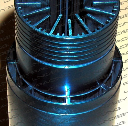

I have been looking at air-water intercoolers to put into my Z for my turbo motor. My Dad showed my this website: http://www.lindseyracing.com/
He found it on some of the 944turbo forums since that is what they normally work on at lindsey racing.
This would drastically reduce any intercooler plumbing and eleminate any pressure drop because of extra tubing and intercooler.
Here is a pic of the internal webbing and coolant passages:
It has 37.15in^2 of surface area for every inch of the tubing on the inside.
445.8 square inches of surface area in a 12" long version!
This is all packed in a 2.75" tube..
