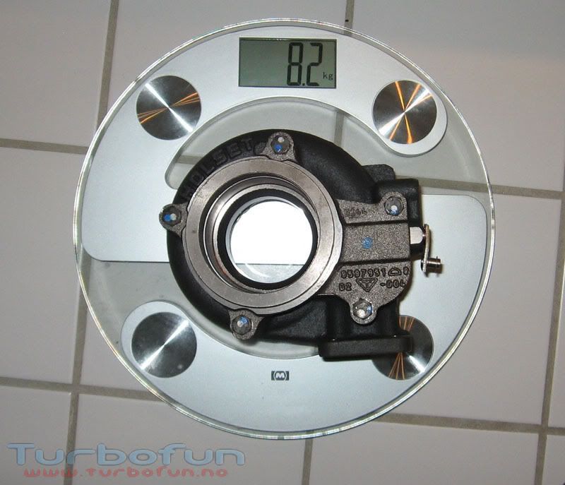

turbo_fb Posted October 18, 2007 Share Posted October 18, 2007 The holset's are used alot in Sweden on Volvo's and bimmers. Alot of information on http://www.savarturbo.se but in sweedish though. haha I'm gonna use a HX40 on my rb25det. It's pretty big and heavy so I might cut of some parts on the exhaust housing to reduce the weight. There is a Audi 1.8l turbo with a HX35/40 here in Norway that's doing pretty good. Not sure about spoolup though. Here are some old pics I have: Exhaust housing: 8.2 kg = 18lb ! Quote Link to comment Share on other sites More sharing options...
Z U L8R Posted October 18, 2007 Author Share Posted October 18, 2007 lemme know how that goes, the hx35 is still on my passenger floor board. it's a pretty heavy bastard lol. mine has a dsm flange on it so it'd be some unnecessary modifications to get it on my t3 flange'd exhaust mani. plus i think the turbo's sweet spot is above my motor's. definately though lemme know what you think when you try it. this is a great forum =] Quote Link to comment Share on other sites More sharing options...

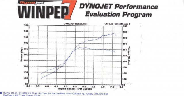

J Taylor Posted October 20, 2007 Share Posted October 20, 2007 No 35r here. I have been running a t04r "big kahuna" for quite a while which is what made the 489 rwhp. I have a gt4094r bolted up at the moment but haven't gotten everything finished yet. I'll try to run down my dyno sheets and post them later today. JT Quote Link to comment Share on other sites More sharing options...

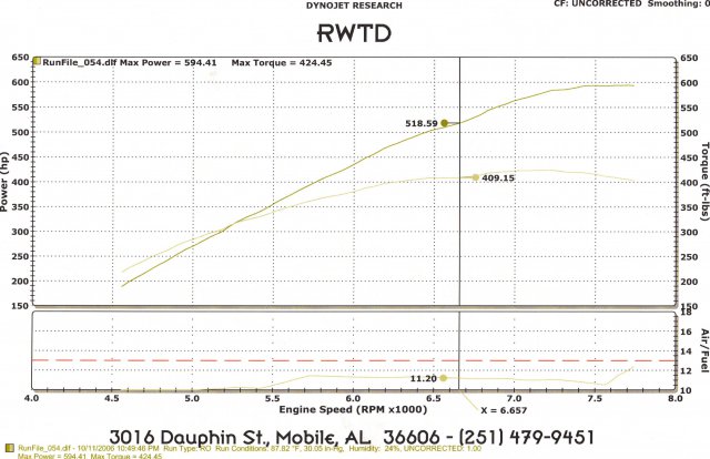

J Taylor Posted October 22, 2007 Share Posted October 22, 2007 Here's the 489hp dyno (5 spd w/ no nitrous) and a 594 (auto with nitrous). I guess I don't have the 615 hp sheet printed. JT Quote Link to comment Share on other sites More sharing options...
