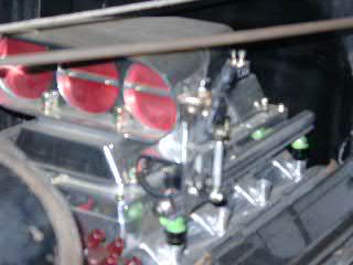

sstallings Posted November 26, 2007 Share Posted November 26, 2007 Guys, Attached .jpg is a picture of the bracket I made out of 2" x 2" aluminum 90 degree angle stock. It holds a GM TPS, with a simple linkage attached to my Enderle Birdcatcher throttle shaft that is modified to work as an EFI throttle body on my 540 cid tall deck big block (this engine is in my street rod, and not in a Z, but the principle is the same. The action is very smooth, and the throttle stops on the birdcatcher allow full motion of the TPS without allowing it to be over extended. I hopw this gives you another option for consideration. Stev(sstallings) Quote Link to comment Share on other sites More sharing options...
