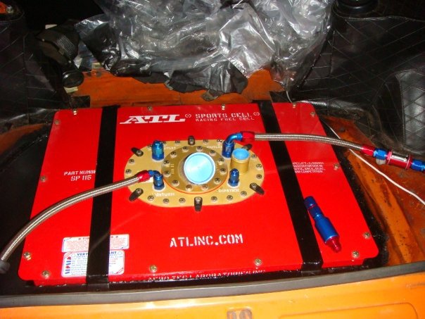

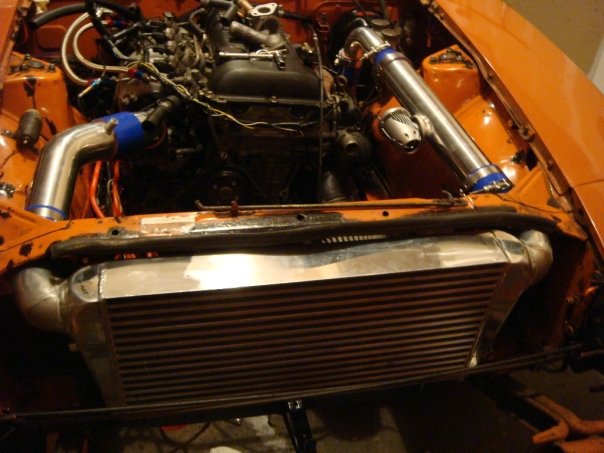

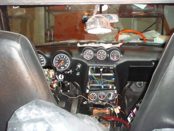

jessejames Posted June 25, 2008 Author Share Posted June 25, 2008 The pic from the gas station is from last year before i put it away. I've started the engine. That was a huge relief. Here are the things i've got left to do. Shorten Driveshaft Finish intercooler piping Get exhaust made up wire the speedo, tach, wideband o2 gauges. and put some plastic pieces of the interior back in. I'm hoping to have it back on the road in the next couple of weeks. The car is a 73 240z. In terms of what you need: Make sure you have a large budget and even more patience. I am finding the wiring the hardest part of the whole job. Thankfuly I've had a lot of help. Your going to need motor and tranmission mounts. I bought mine from http://www.whiteheadperformance.com in toronto ontario. You can also get them from http://www.vildinimotorsport.com and http://www.mckinneymotorsports.com You will need intercooler, piping, exhaust, You need your drive shaft shortened. I ran a fuel cell. You might be able to use your stock gas tank if its Fuel injected. I'm not sure what size your fuel lines are but you may want to get bigger ones. I'm running Earl's hardlines under the car and the braided stuff in the trunk and engine bay. Your going to need a new fuel pump. If you want to keep your heater core, your going to need some custom shaped lines. Theres lots of little things. If i think of more i'll post. Or just ask. Quote Link to comment Share on other sites More sharing options...

jessejames Posted July 24, 2008 Author Share Posted July 24, 2008 Originally I went to Tigerjdm. I wanted a blacktop s14. I had purchased a 4age from them a few years ago and so thats why i went back. All the s14s were located under the s13s and the employees were too lazy to move any of the engines for me to have a look at one. So I went to a place just around the corner but I can't remember the name of the place. Make sure you do a compression test on the spot. Also check inside the intercooler pipes for oil. They wash the engines, so its a little hard to know what shape there in. I paid $1800 CAD. That included the engine, tranny, ecu, wiring harness, ignitor chip. Thats a blacktop s13. I think the place i bought it from was http://www.torontojdm.com , although i'm not 100% sure. Also if you pay cash its going to be cheaper than what they advertise. I've attached a few pics. There better quality than earlier ones. Quote Link to comment Share on other sites More sharing options...
