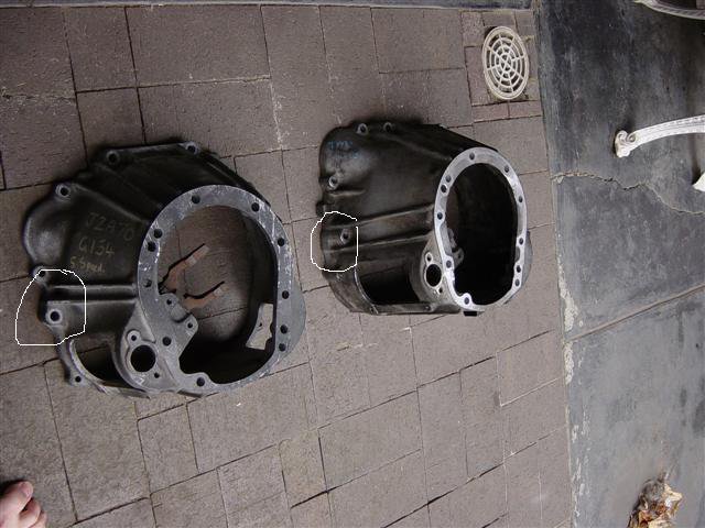

Guest allight Posted December 30, 2007 Share Posted December 30, 2007 after a lot af serching found this picture on supra forums showing 7m and 1jz bellhousing together, the post says the 1j is the shorter one,if this is right I have got $20 worth of lucky. only differance that is obvious if you are not looking at them at the same time is the position of this bolthole circled. can anyone confirm that the 1j is definately the shorter one with no bolthole between the two ribs and the 7m is the one that has the bolthole between the 2 ribs Quote Link to comment Share on other sites More sharing options...

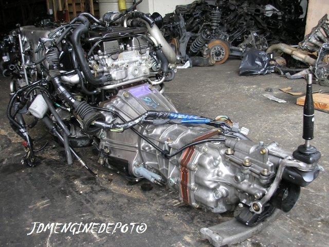

Guest allight Posted January 3, 2008 Share Posted January 3, 2008 this picture from ebay the bell that has no bolthole between the ribs on the left side is definately the 1j not the m7.unfortunit this seller is on the east coast ,good price on what i want Quote Link to comment Share on other sites More sharing options...
