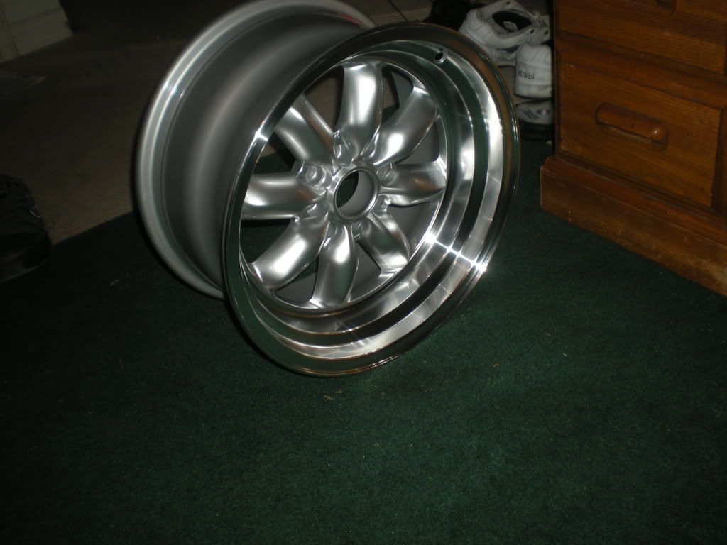

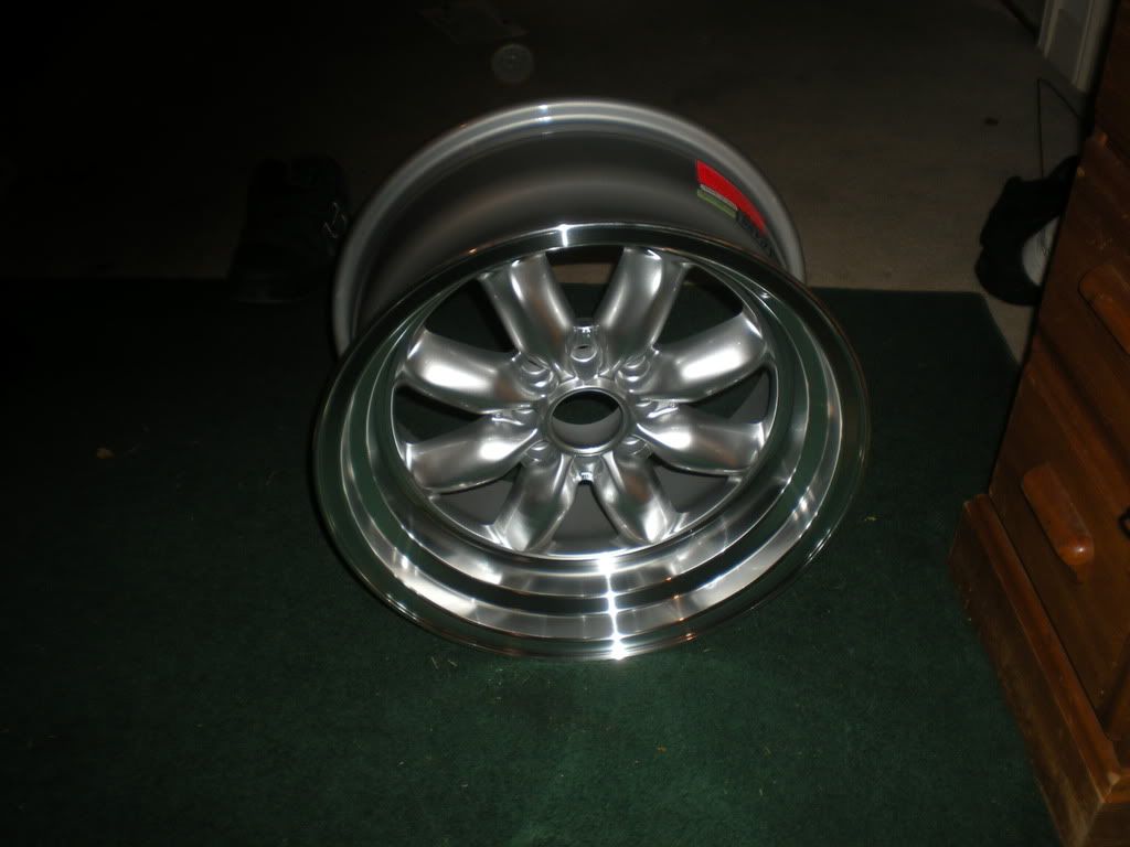

timbo1jz Posted October 27, 2008 Author Share Posted October 27, 2008 I haven't posted in a little while, but I have got a lot done. Finally got around to painting the valve covers, I modified a Toyota Camry throttle cable to work on the 1jz thanks to RussZed's idea. Got a set of Sportmax wheels for the z too. Everything in the engine bay is almost done. Quote Link to comment Share on other sites More sharing options...

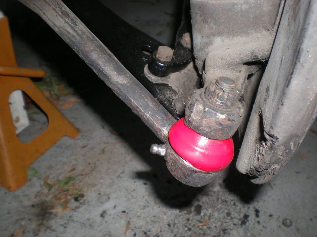

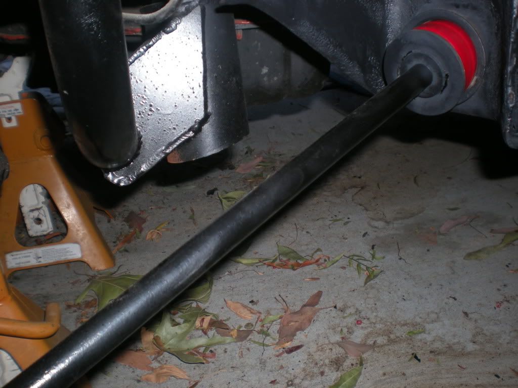

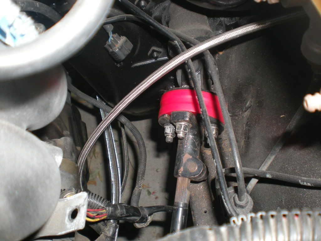

timbo1jz Posted October 27, 2008 Author Share Posted October 27, 2008 Got all the bushings in the front end replaced with poly bushings. Control arm bushings, rack bushings, steering coupler bushings, strut rod bushings, and tie rod end grease boots. Quote Link to comment Share on other sites More sharing options...

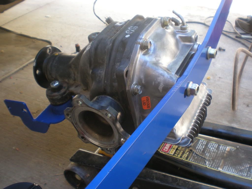

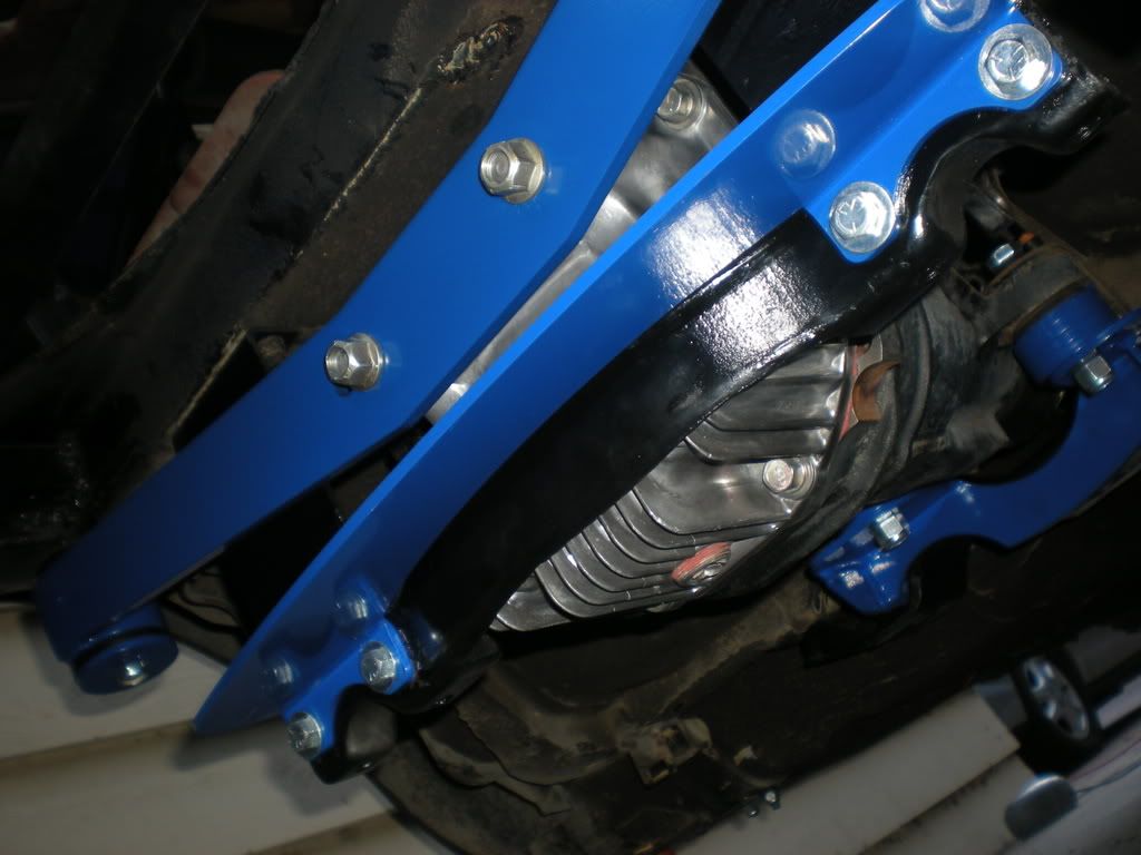

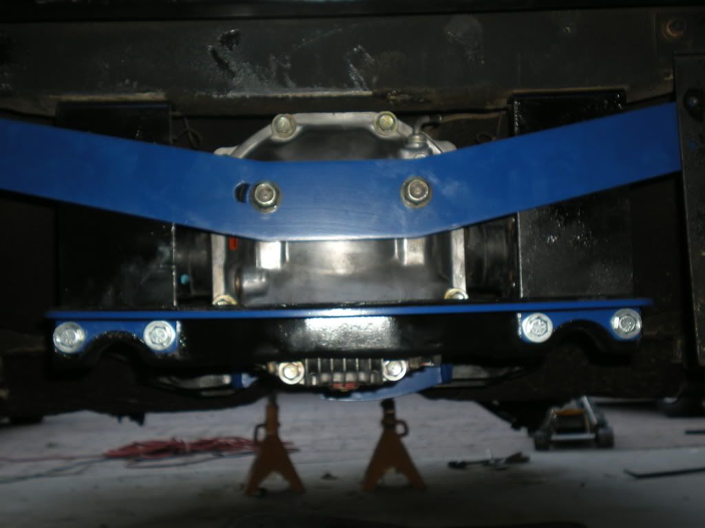

timbo1jz Posted October 27, 2008 Author Share Posted October 27, 2008 Oh, and my favorite part. Infinity Q45 r200 LSD installed with modern motorsports mounting kit. Working on the rear end now, doing all the bushings, custom lower control arms, axels, ect... Quote Link to comment Share on other sites More sharing options...
Gritz Posted October 27, 2008 Share Posted October 27, 2008 Hard at work huh!!! Great job, everything really looks good...How do you like that diff mount kit? Quote Link to comment Share on other sites More sharing options...

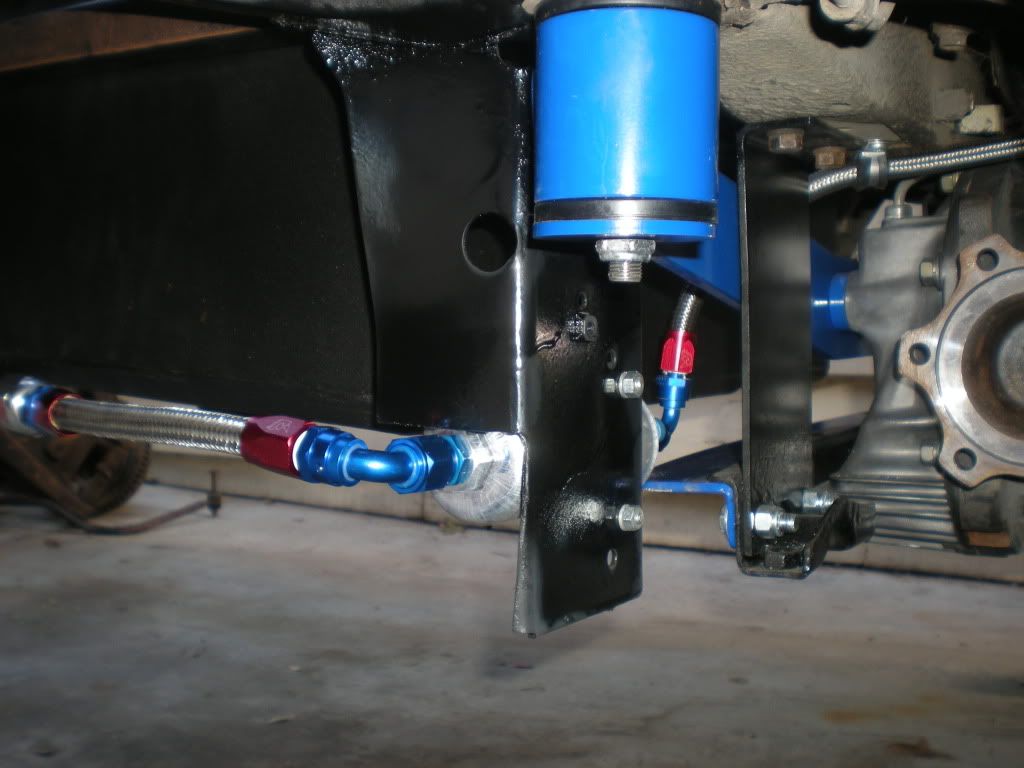

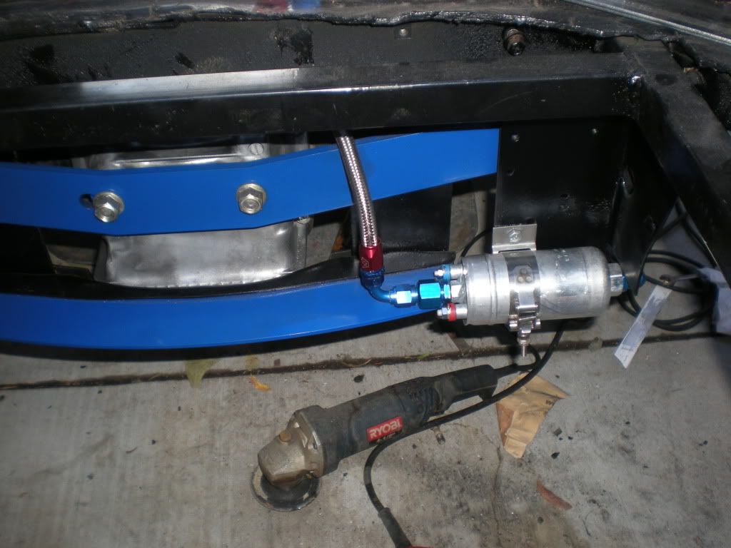

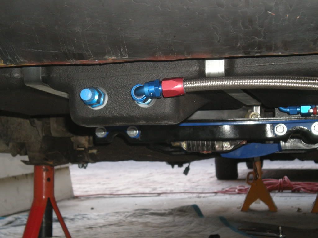

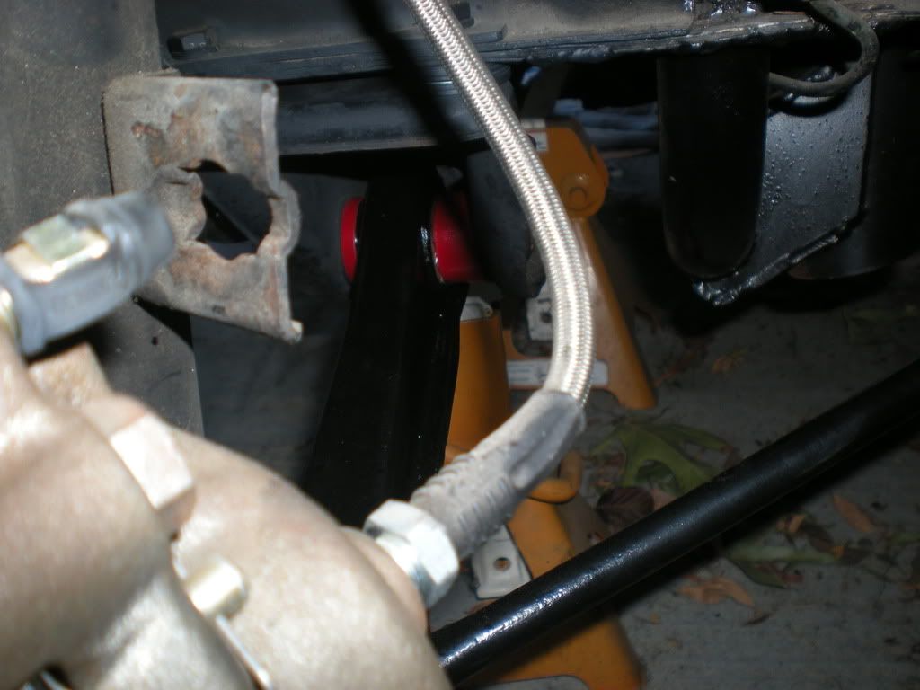

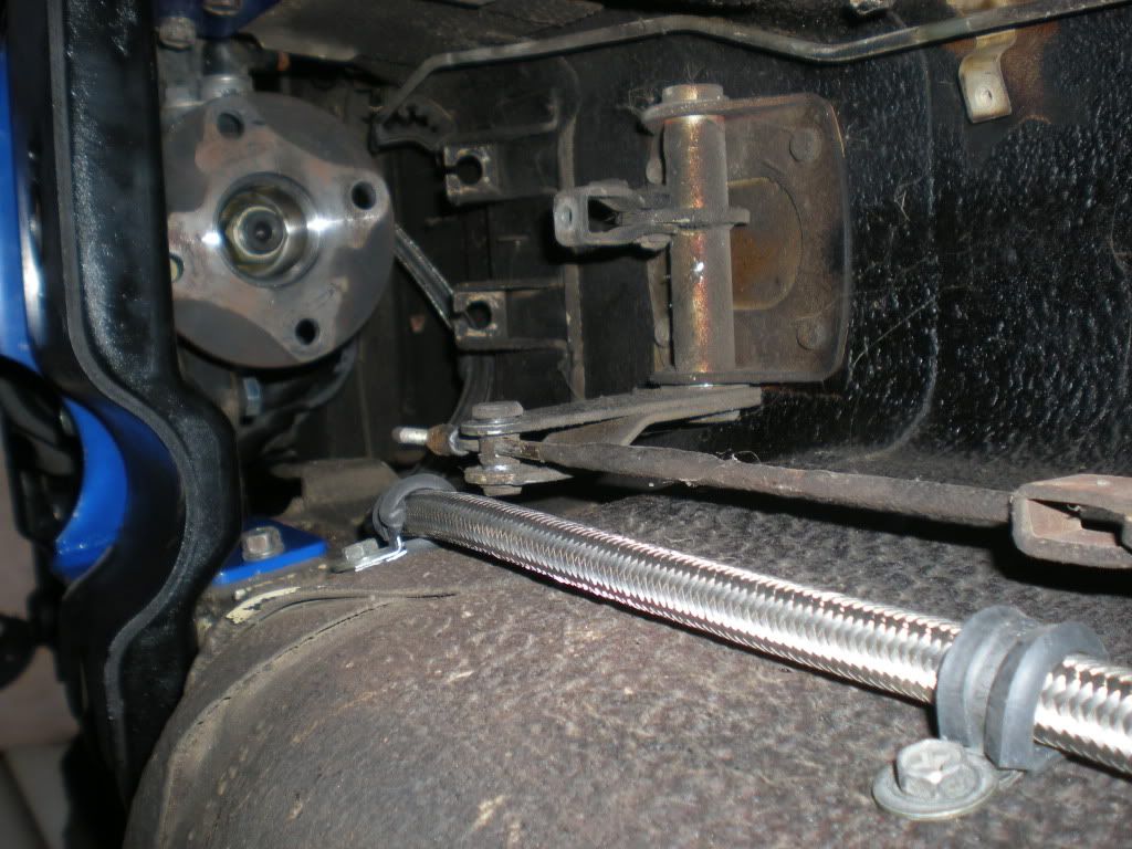

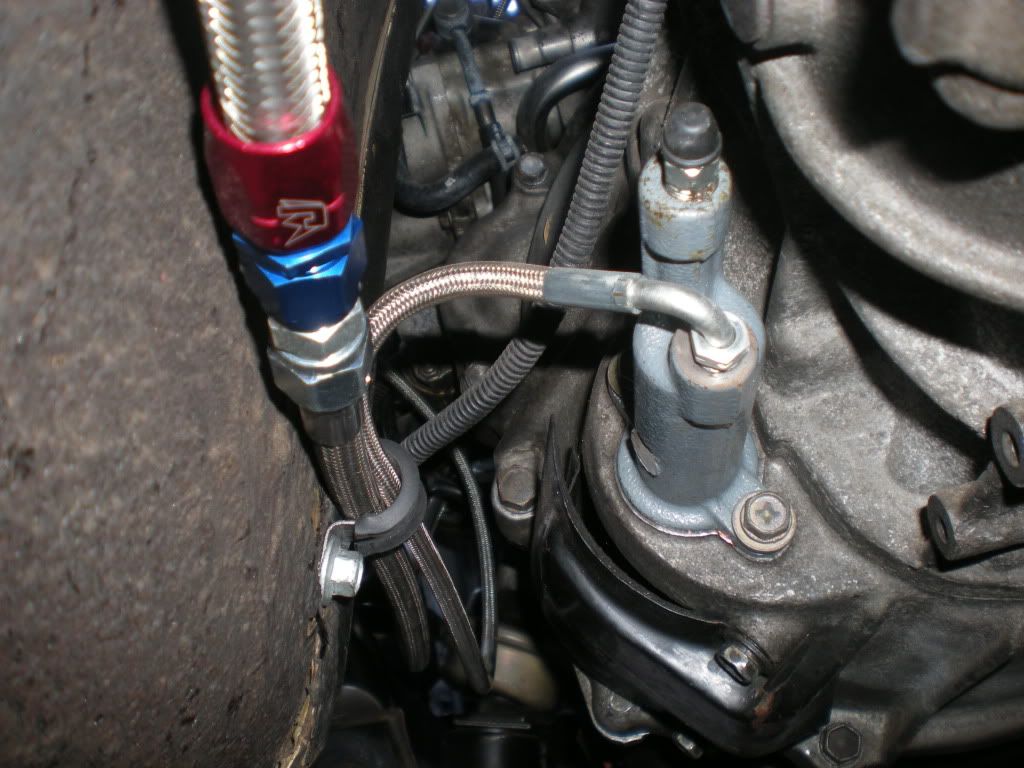

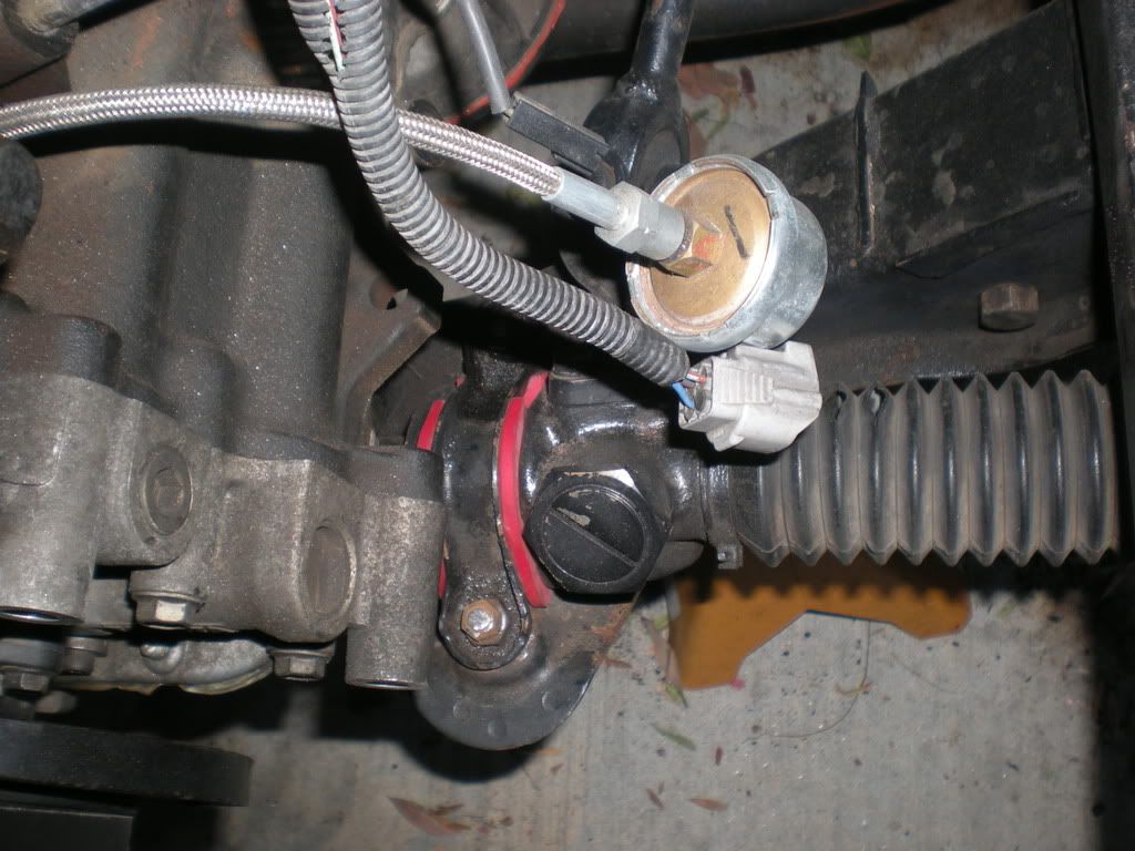

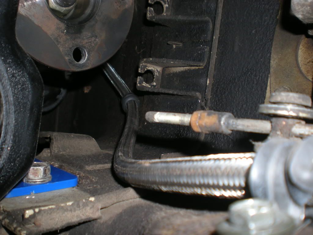

timbo1jz Posted November 3, 2008 Author Share Posted November 3, 2008 Got my fuel feed system done today. Summit racing 12 gallon fuel cell with -8 feed line into a Bosch motorsports 044 fuel pump (good for 700 whp) with a -6 feed from the pump to the engine. I have an inline fuel filter before the pump. I will do the return next. Here are a couple pics. It looks nicer in person than in the pics. Quote Link to comment Share on other sites More sharing options...

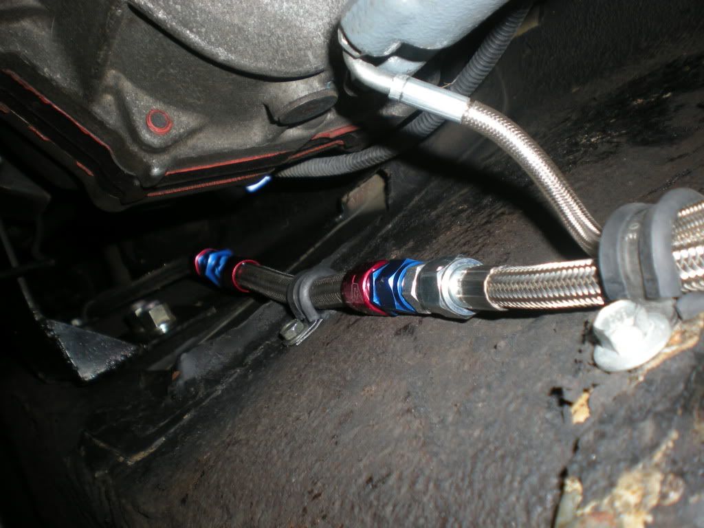

timbo1jz Posted November 3, 2008 Author Share Posted November 3, 2008 Here's a couple more- Quote Link to comment Share on other sites More sharing options...

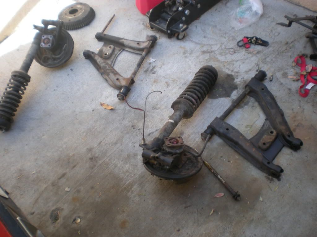

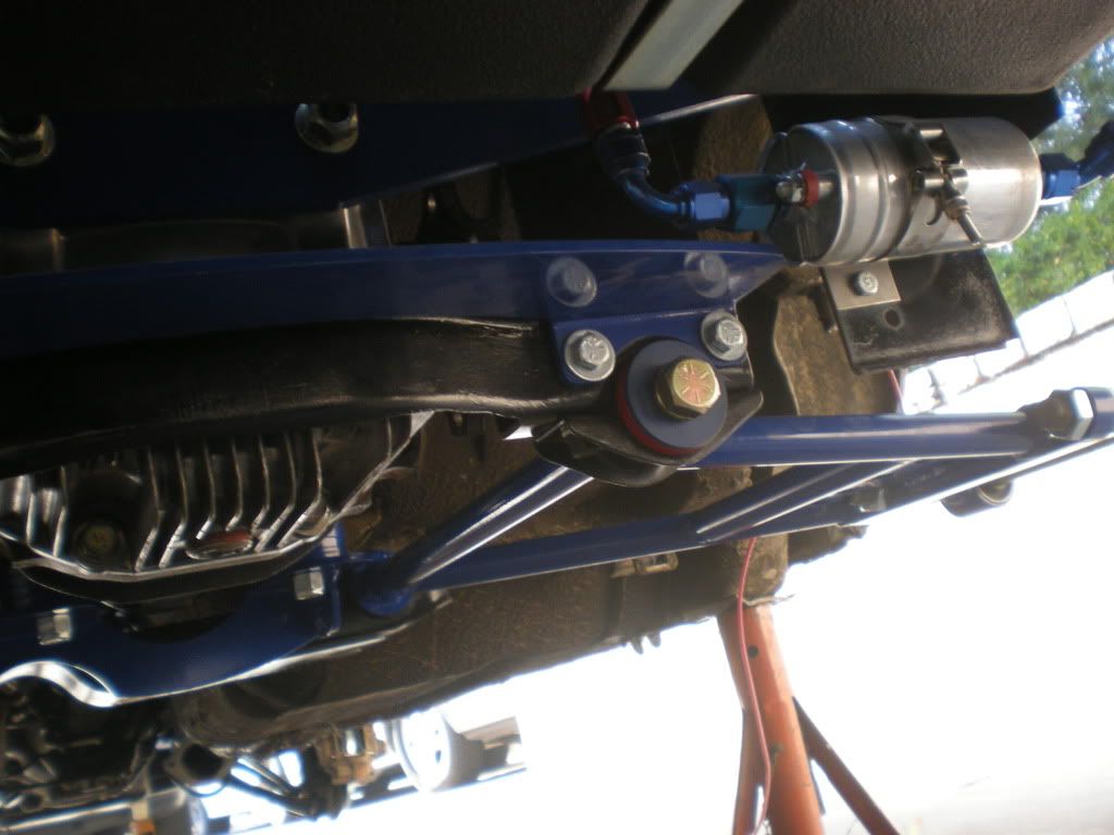

timbo1jz Posted November 27, 2008 Author Share Posted November 27, 2008 Got some new pics. Fuel system is done, and I removed the complete rear suspension and got the new Modern Motorsports control arms in. I have ground control coilovers and tokicos on the way. Replacing the spindle pins while I have it appart. Quote Link to comment Share on other sites More sharing options...
