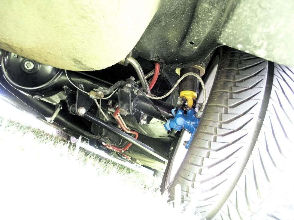

tube80z Posted January 28, 2008 Share Posted January 28, 2008 The RX7 is a 4 link setup, and the wagon is a leaf spring setup. Not that this is an insurmountable obstacle, but it's a bit involved. A friend of mine created a bolt-in 4 link conversion for a 510 wagon. It was developed for high HP 2-door cars. The difference between the 4-link and the trailing arms is amazing. Unfortunately this isn't offered for sale. It was on a yellow 510 with a turbo KA that was at Shasta a few years back. In case anyone saw it. Cary Quote Link to comment Share on other sites More sharing options...

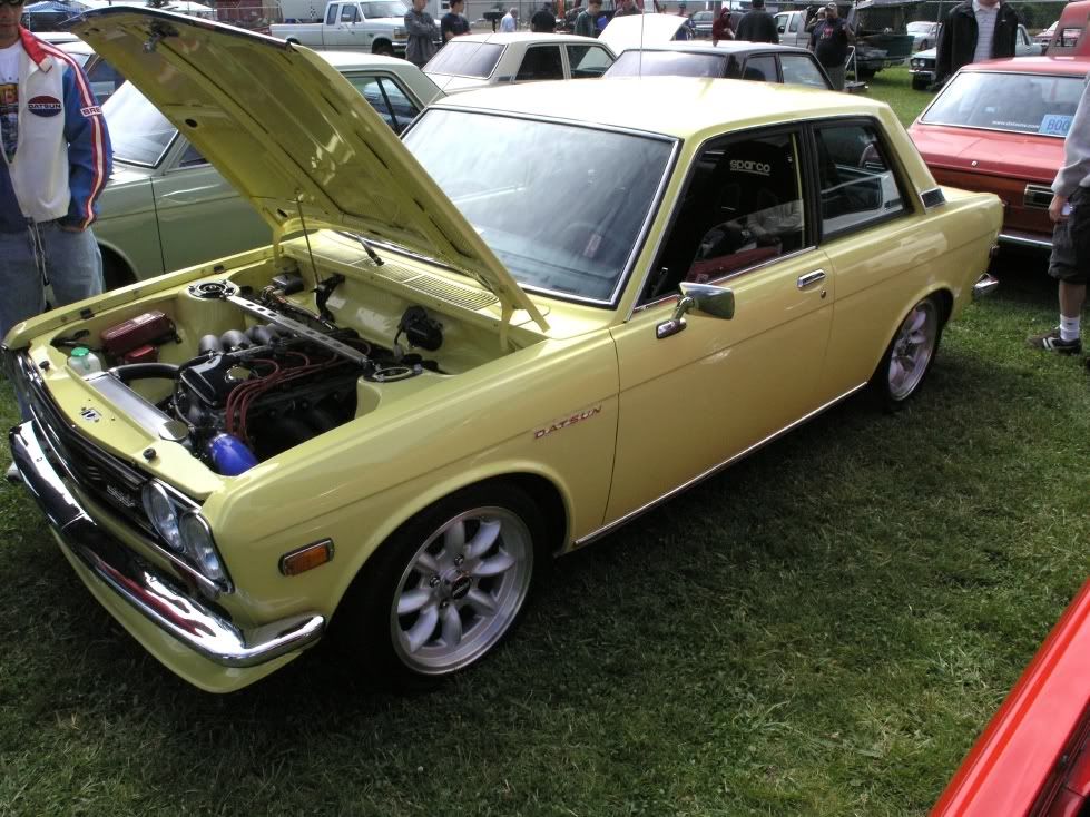

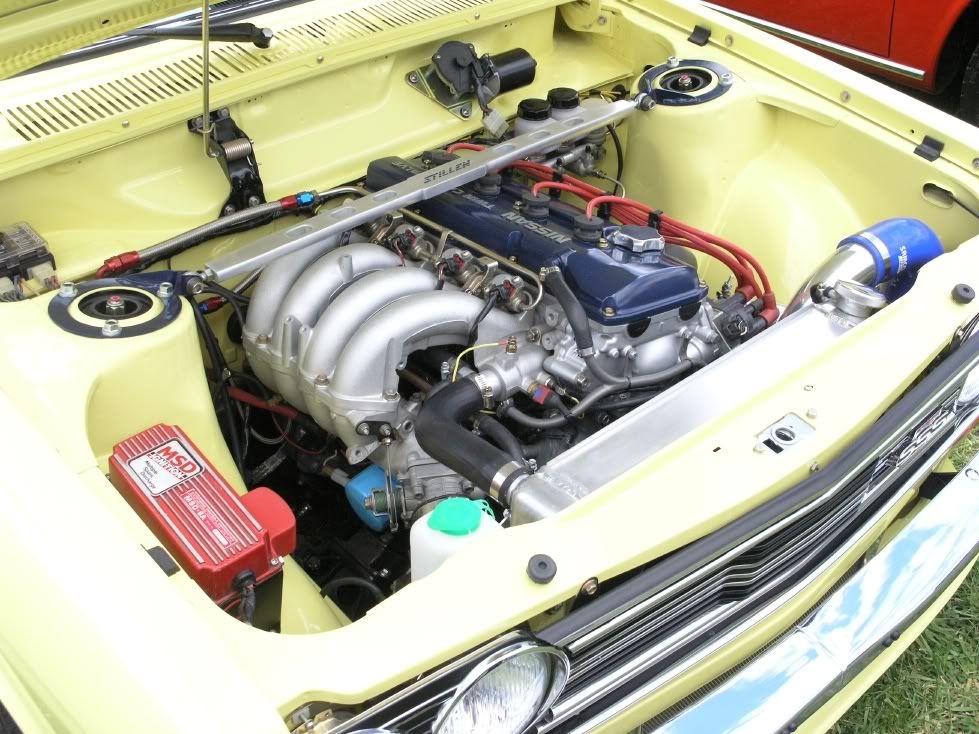

Administrators RTz Posted January 28, 2008 Administrators Share Posted January 28, 2008 Unfortunately this isn't offered for sale. It was on a yellow 510 with a turbo KA that was at Shasta a few years back. In case anyone saw it. Stunning car. Probably my favorite Dime... . . Unfortunately, this is the only pic I have of the rear suspension... Epperly was responsible for the 4 link, yes? Quote Link to comment Share on other sites More sharing options...
tube80z Posted January 29, 2008 Share Posted January 29, 2008 Epperly was responsible for the 4 link, yes? Yes, Steve and Al. They have a jig at their shop and have done two or three wagons. That car is by far the fastest 510 I've personally driven. Maybe even the fastest car I've ever driven. That includes Kipperman's Z and a few others. A real beast but not scary. Cary Quote Link to comment Share on other sites More sharing options...
