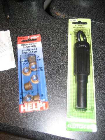

TrumpetRhapsody Posted February 6, 2008 Author Share Posted February 6, 2008 Made a trip to autozone to price some stuff and pick up a few items I'll need this weekend. As shown in the pic, I followed this site's suggestion on the shifter bushings. I grabbed part #38374 because they didn't have #38377 in stock. Twas $5 I also picked up the clutch pilot tool I found out I'd need when I took the pressure plate and the clutch dropped out of place. (give me a break, I've been used to autos, I'm new to this stuff). Twas $3 Assuming I don't have what I need in that cache of parts we're picking up this Friday, The slave cylinder would be $18, dizzy cap and rotor $14, ignition coil $26, and clutch fork $31. We couldn't find a throwout bearing in the system. Hopefully I'll have most of that in the parts cache. Quote Link to comment Share on other sites More sharing options...

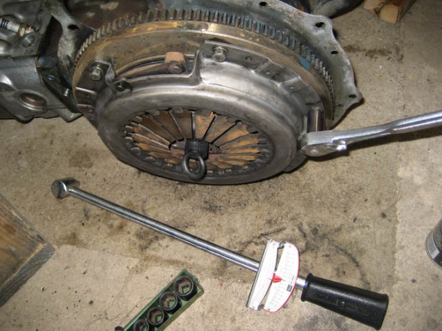

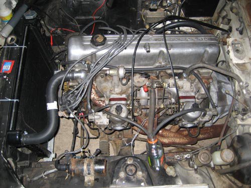

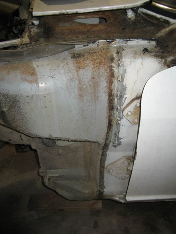

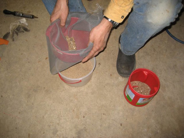

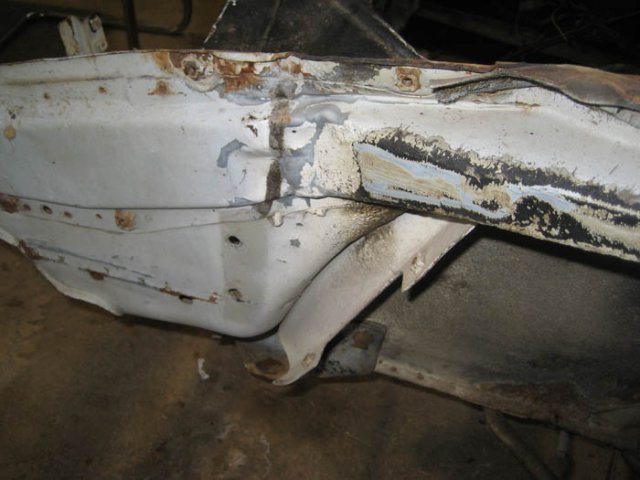

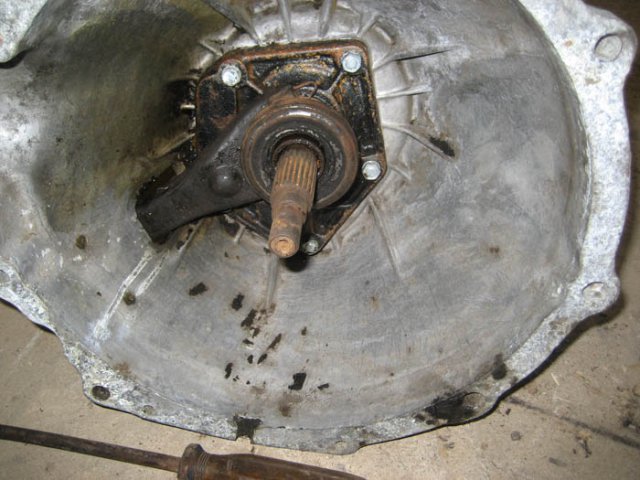

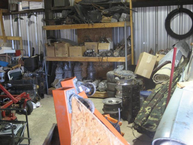

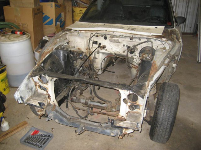

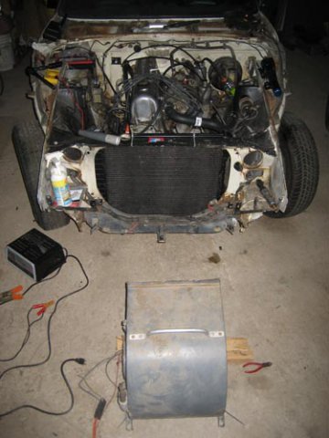

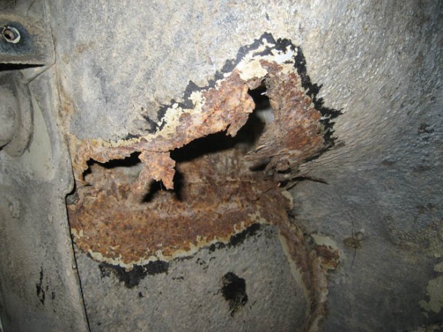

TrumpetRhapsody Posted February 11, 2008 Author Share Posted February 11, 2008 I'm going to reference the attached pics by number - ie: (1) Alright well the main goal of this weekend was to pick up the cache of parts, and get them organized into the shop (1). Now for the car's progress: I got the clutch re-installed (2). Throwout bearing and arm installed (3), hopefully correct for my pressure plate Got the fenders off (4) Found some trauma under the fenders (5-6). Both sides are a little crunchy and welded like that. Hopefully it's not too big of a deal for my power goals. So the list for the next few weekends: Fix battery area rust hole (7) Rebuild the carbs Source all the bolts I need to get everything put together and installed Mount the motor Start plumbing lines and attaching wiring Quote Link to comment Share on other sites More sharing options...

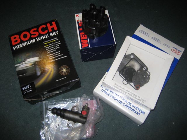

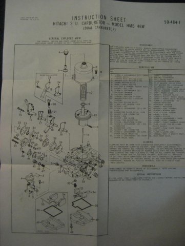

TrumpetRhapsody Posted February 13, 2008 Author Share Posted February 13, 2008 Well I made some preparatory purchases, stuff I know I'll need. Cost me about $100 for all of it. I'm not so sure that carb rebuild kit is going to work. It looks like a different SU model. I have another thread going to talk about that though. I've also got a deal going to get all the bolts and such I'll need. Hopefully that all comes through before I get back out to the shop. Quote Link to comment Share on other sites More sharing options...

TrumpetRhapsody Posted February 20, 2008 Author Share Posted February 20, 2008 Shows what they know. It held up great the way you taped it. Project update while I'm here: I returned the carb kits. I think I may just try to lube it up and see if I can get them running as is. If not I'll rebuild at that point. I'm currently pursuing a lead on a R200 LSD. Not sure if it's going to pan out or not, but it would be a pretty cool addition. I wasn't planning on trying to find one for quite some time, but this one kinda forced itself on me, haha. Quote Link to comment Share on other sites More sharing options...
