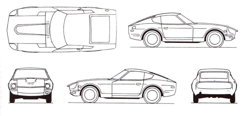

badjuju Posted February 23, 2008 Share Posted February 23, 2008 I'm about to start my wiring harness, and I'd like to draw a diagram on the car. I'd like to be able to draw the location of each device and have a checkbox beside each, to show whether it's been wired or not. I've googled around, and haven't found what I was looking for. Does anyone have a pic of the top of their car? as in, just showing the outline of the car from the top view? Quote Link to comment Share on other sites More sharing options...
BurnoutZ Posted February 24, 2008 Share Posted February 24, 2008 aziza! Quote Link to comment Share on other sites More sharing options...
Vintage Posted February 24, 2008 Share Posted February 24, 2008 Hows this? Quote Link to comment Share on other sites More sharing options...
badjuju Posted February 24, 2008 Author Share Posted February 24, 2008 ooooh that is sweet. thanks a lot guys! Quote Link to comment Share on other sites More sharing options...

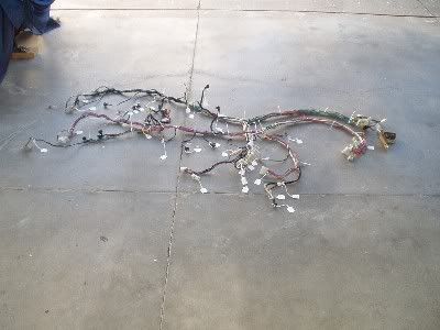

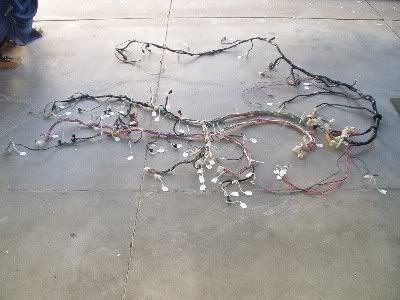

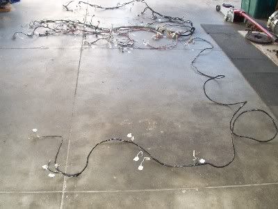

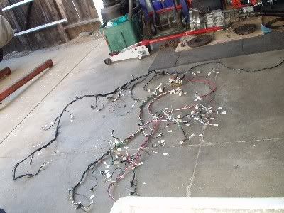

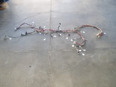

Dragonfly Posted February 24, 2008 Share Posted February 24, 2008 I'm about to start my wiring harness, and I'd like to draw a diagram on the car. I'd like to be able to draw the location of each device and have a checkbox beside each, to show whether it's been wired or not. I don't have a picture like you want (and I see some have already been posted for you) but I do have these pictures from my 72' 240Z. This is the "front" dash harness. "front and rear" deash harnesses together. dash harnesses with engine harness. dash, engine and body harnesses. All harnesses together but at a different angle. As you will notice all the connectors have a tag on them, each tag identifies what it plugs into and what it is. Some of the wires you see in these pics may not look correct and that is because this harness(s) is modified and some wires had been removed and some new ones have been installed (second pic). At the time that I disconnected each plug I wrote out the tag and hung it, when everything was removed I laid it all out like you see in the pictures then I drew a wiring diagram so when it gets all put back into hard to reach and see places I can insure everything is put together correctly. Dragonfly Quote Link to comment Share on other sites More sharing options...
