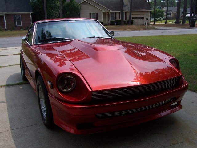

What do you guys think? The pic is of my car. People see the hood and ask me what's under it... I always hate saying "it's got the stock motor in it" They expect me to say V8!
