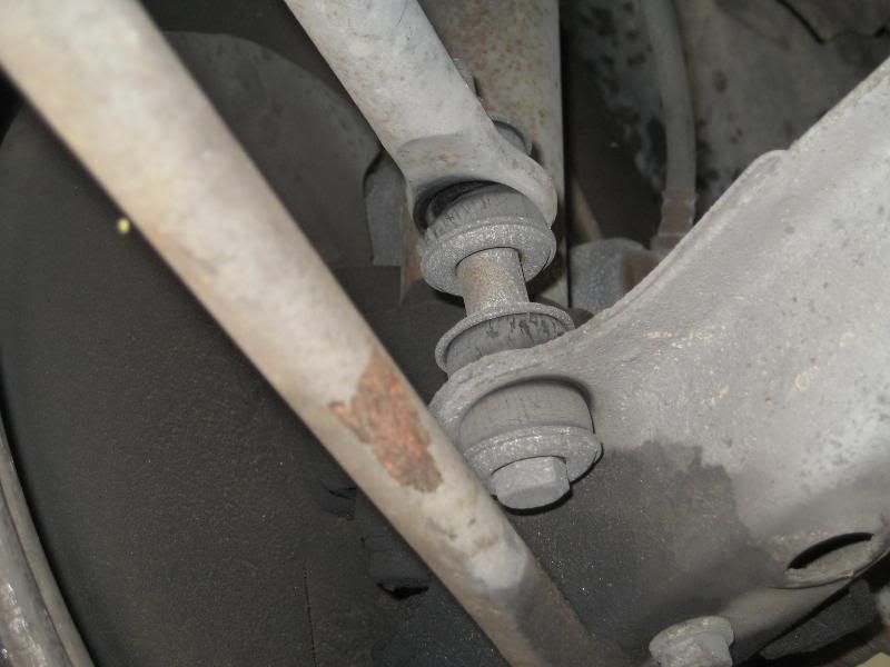

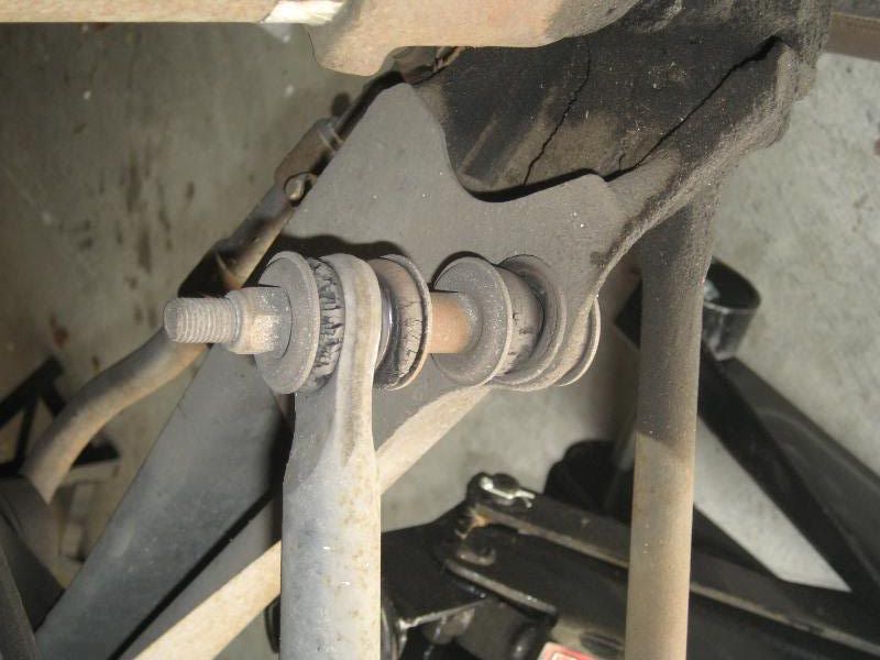

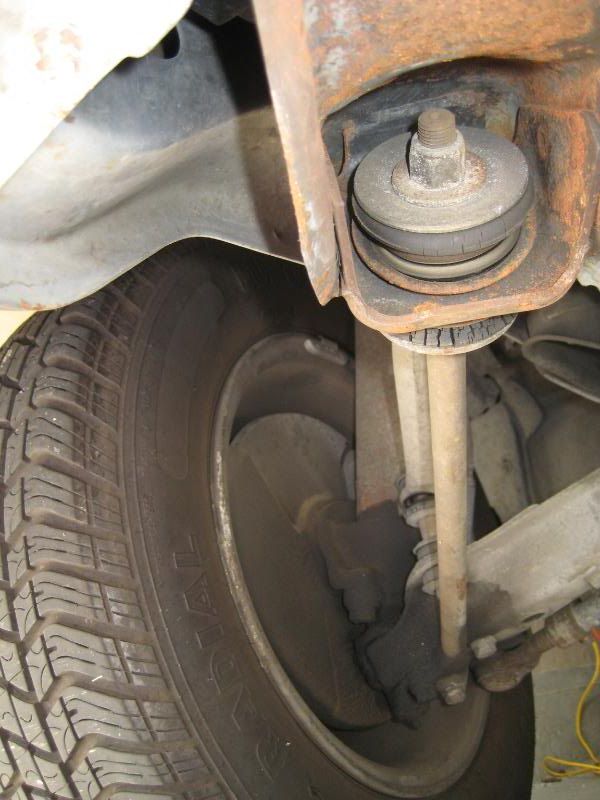

PhilbertZ Posted April 5, 2008 Share Posted April 5, 2008 Hello all, Great forum here - learning a lot and having an adventure with my (new to me) 1980 ZX. I was replacing the clutch master cylinder today and while under the car, noticed that many of the bushings in the front of the car were badly cracked. I'm semi-familiar with cars and repair work, but have not done suspension work yet. The photos below show the bushings I found and their condition. My questions are: 1) what are these (control arm bushings?) 2) Do they *need* to be replaced, and if so, can it wait? 3) What kits are avaialable to replace them/how much is it going to run me for parts (I want to do myself)? Thanks in advance for any help! Phil Photos: Quote Link to comment Share on other sites More sharing options...
rudypoochris Posted April 6, 2008 Share Posted April 6, 2008 Those are sway bar end link bushings and tension control rod bushings. You can fund replacements in rubber or urethane through multiple suppliers. (Motorsport Auto, Black Dragon, etc.). They do not NEED to be replaced, but you should. Quote Link to comment Share on other sites More sharing options...

PhilbertZ Posted April 6, 2008 Author Share Posted April 6, 2008 Thanks so much guys! Do these kits usually come with instructions for where each bushing goes? Seems like it would be easy to mistakenly swap them since the sizes are so similar... Quote Link to comment Share on other sites More sharing options...
jerryb Posted April 6, 2008 Share Posted April 6, 2008 I believe they are the same size. Your sway bar bushing are just compressed and distorted from old age. Get new ones!!! Your ride will be much tighter. Quote Link to comment Share on other sites More sharing options...
KiwiCowboy Posted April 6, 2008 Share Posted April 6, 2008 Thanks so much guys! Do these kits usually come with instructions for where each bushing goes? Seems like it would be easy to mistakenly swap them since the sizes are so similar... If the sway bar end links and T/C rod bushings look that bad, you should also replace your sway bar frame bushings too. I replaced all my front suspension bushings with Energy Suspension urethane for < $40. Quote Link to comment Share on other sites More sharing options...
