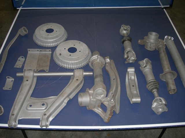

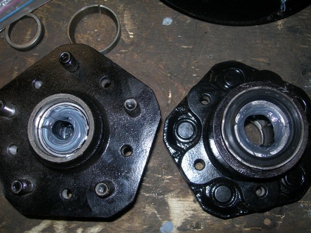

So here is a few parts that I picked up...i put all the bearing and raices in the hubs today and the only thing that standing in my way of assebling the hub/rotor assy on the perch are my spacers that i order from MM.

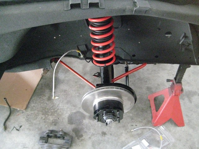

Thats what i though, but i didn't know for sure...let me tell you what though once you put swaybar in on one side it it hell trying to put it in the other...the best way i found to do it was use a visegrip clamp underneath the trasferlink and on top of the swaybar and compress. Also found that getting the shock on when the ball joint isn't mounted to the bottom of the shock was pretty tough as well, but if you take some channellocks and twist the part that the tie rod mounts to...you can control it pretty easy.
