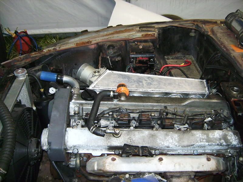

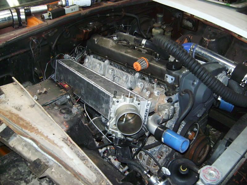

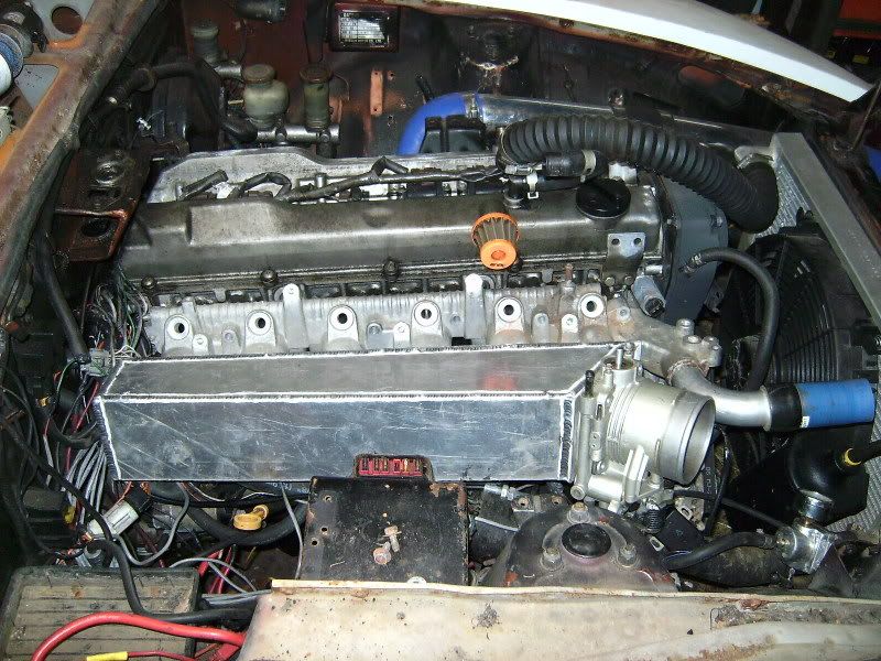

more pics guys, i finally got the intake welded, man can my buddy weld :D
and a pile of parts ;) getting one more tote tomorrow for the head.
oh yea the bearings came in too, just need the pistons, rods and gasket set and i can start building the engine. Im just happy im making progress:D
Thanks for the warning,this is my second intake like this. Evan has my first one and beleive me they wont bow ;) it's not really sheet metal its more like plate and it is about 1/4 inch thick :D we got a ton of it lying around the shop so i used the big sheer and cut some pieces, tacked it up with an aluminum mig welder then had my buddy tig weld it for me.
Intake looks awesome. You may want to consider welding braces around the intake so it doesn't balloon and possible split. I have seen it happen with a few sheet metal intakes.
Mike
Heres what happened to mine while trying to start it up after I swapped out ECM's from a Tec2 to a Tec3r. The CAS sensor was sync'd wrong at the time...
