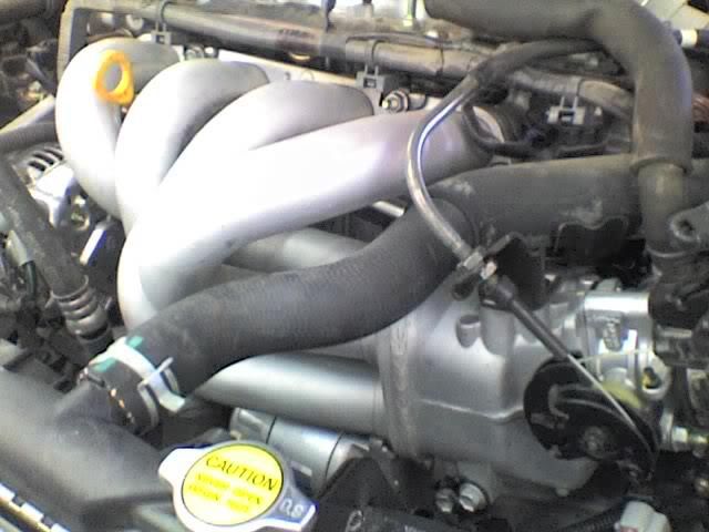

Take a look at some of the newer Toyota Manifolds, they look just like that: a set of Tube Headers with a T/B stuck on the 'collector flange' and made of aluminum instead of steel.
We had one come through the shop today. Remembering this thread, I snapped a picture on my phone. The runners appear to be equal length.
