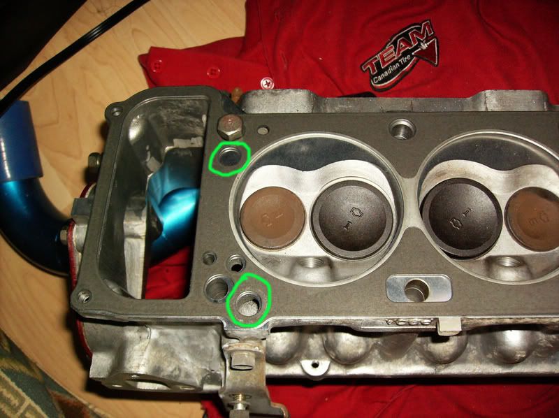

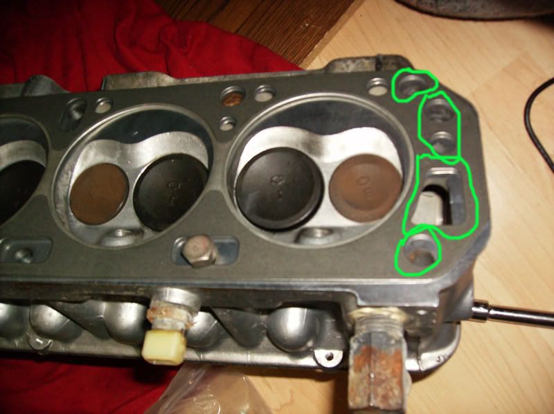

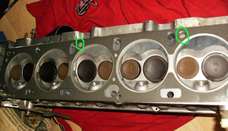

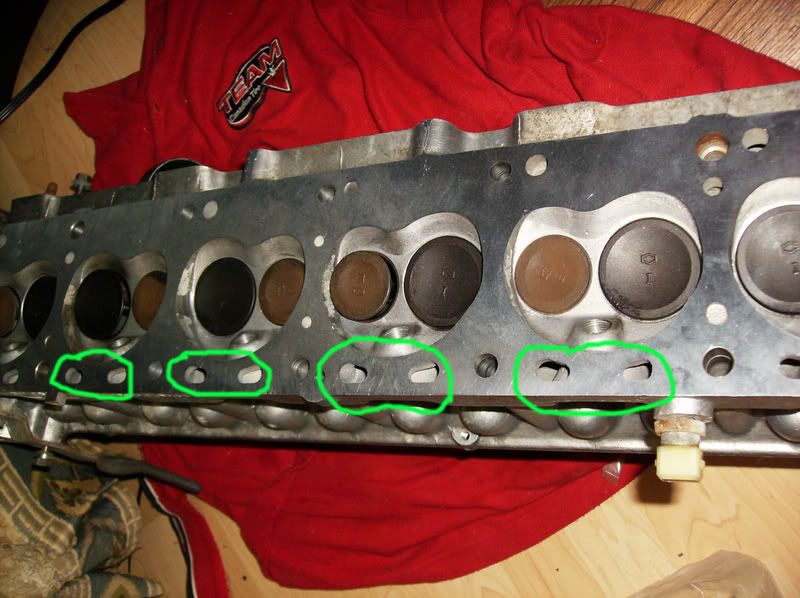

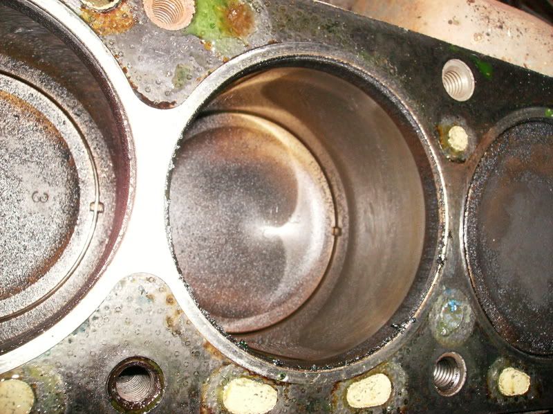

m1ghtymaxXx Posted May 31, 2008 Share Posted May 31, 2008 Well I had planned to throw the top end back on my motor back together this weekend, and thought it would be a good idea to see what I could find out on hybridz before going ahead. First thread I came across explained that there are several different coolant passages configurations between L-series engines. I figured since all f54's should be same, and me rebuild kit is specifically for an 83 turbo, I should be good to go, but thought I should compare the headgasket to the head just in case. Well here's what I discovered: with the headgasket on. I've circled the coolant/oil (could someone tell me which are which?) passages left open: And with the headgasket off, I've circled the passages blocked: Now I just went back and dug up some old pics of my block, and it looks like the stock HG had provisions for the passages, but they didn't continue into the block. So what does this mean, will this gasket work? Edit: This is a P90a and f54 turbo block from an 83 zxt. I'm quite certain the motor had never been opened up before. Quote Link to comment Share on other sites More sharing options...

m1ghtymaxXx Posted June 1, 2008 Author Share Posted June 1, 2008 Read up on the water flow of the l6. http://forums.hybridz.org/showthread.php?t=125186&highlight=cooling I couldn't find an answer in that thread. I guess if its not blocking any passages in the block, I should be good to go? Quote Link to comment Share on other sites More sharing options...
blue72 Posted June 2, 2008 Share Posted June 2, 2008 Did you read my post on page 7 of that thread? What I've come to find is that you buy the gasket for the block. There were different designs for different years. They blocked different passages for reasons that I haven't found yet, but they must have had their reasons none the less. The FSM pictures I've found of head gaskets match their Fel-Pro counterparts exactly. Quote Link to comment Share on other sites More sharing options...
