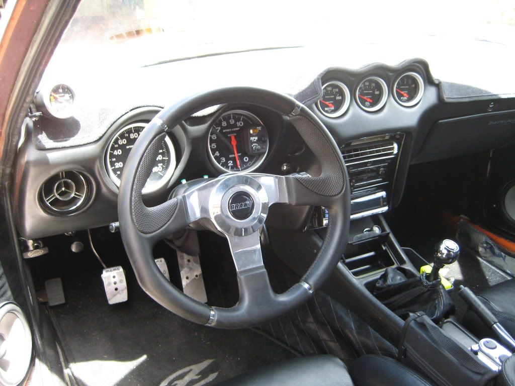

Bartman Posted August 18, 2008 Share Posted August 18, 2008 LED's installed between the tach and speedo. Quote Link to comment Share on other sites More sharing options...
Armand Posted August 18, 2008 Share Posted August 18, 2008 Bartman, you wouldn't have made an extra piece of that cluster would you? I remember reading you made it out of fiberglass. Quote Link to comment Share on other sites More sharing options...
Bartman Posted August 18, 2008 Share Posted August 18, 2008 Bartman, you wouldn't have made an extra piece of that cluster would you? I remember reading you made it out of fiberglass.No, I didn't really make anything. All I did was drill three holes into the dash and then pushed LED's into them. Maybe your thinking of David's setup (1 tuff z)? Quote Link to comment Share on other sites More sharing options...
