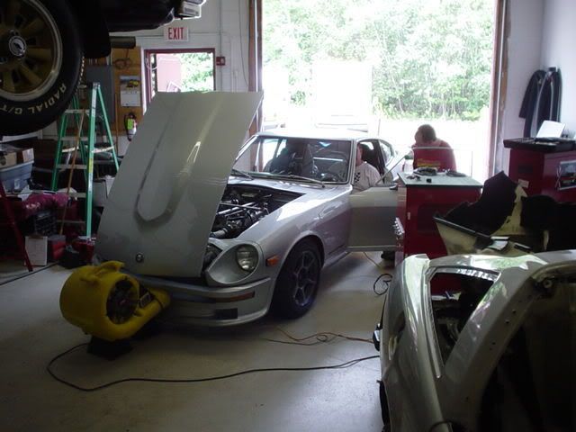

A few weeks ago I finally go my turbo 240Z back on the Dyna Pack for tuning. I recently upgraded the turbo from a T04B/T3 stock to a T04E/T3 stage 3. I also added a 3" exhaust. The new turbo use the Ford style built in waste gate.
The main issue I encountered with boost creep. The boost would continue to climb no matter what I se the boost controller to. After much fiddling on the dyno, I couldn't get the boost to be stable. Here is the final dyno chart:
