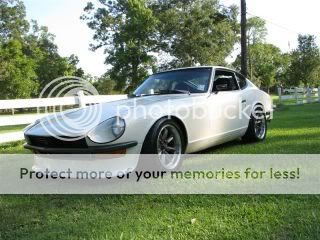

karl Posted July 20, 2009 Author Share Posted July 20, 2009 (edited) New pics with my new fiberglass bumpers. the steel ones may take a while to fix so for now it's fiberglass, painted in charcoal metalic. why are the pictures so small? Edited July 20, 2009 by karl ? Quote Link to comment Share on other sites More sharing options...
yhlz Posted July 20, 2009 Share Posted July 20, 2009 damn karl, you beat me to the paint. i'm in the process of going white. Quote Link to comment Share on other sites More sharing options...

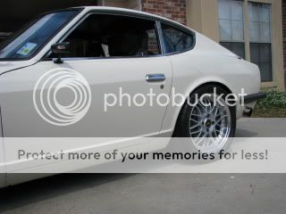

karl Posted March 19, 2010 Author Share Posted March 19, 2010 What do you think? I don't know if I like the 17" wheel on the datsun. It's a Simmons 3 peice. Quote Link to comment Share on other sites More sharing options...
Nelsonian Posted March 20, 2010 Share Posted March 20, 2010 What do you think? I don't know if I like the 17" wheel on the datsun. It's a Simmons 3 peice. I like the Simmons look on there, but dig the Rota's more aggresive appearance more. I am a big fan of 17" wheels on an s30 for tire selections and aesthetics fwiw.... Quote Link to comment Share on other sites More sharing options...
