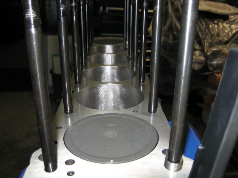

RisingSun Posted October 25, 2008 Share Posted October 25, 2008 I've got those KA24 pistons that I bought from 1 Fast Z, but didn't come with enough pin clips and he never sent them to me. I never installed them in my engine build. I recently found some pin clips at my local Nissan dealer that look good, but I am still a couple short. They are ITM brand. I can send you some pictures and if you like what you see, make me an offer. Â This is what I went with instead. They are ceramic coated, but I will have to find out from the builder what brand they are. If you like how they look I will find out where he got them and pass that info on to you. Â Quote Link to comment Share on other sites More sharing options...
sorealsosurreal Posted October 25, 2008 Author Share Posted October 25, 2008 yeah, let me know what those ones are and from where, im guessing they ar 89mm? did you deck your block? Quote Link to comment Share on other sites More sharing options...
RisingSun Posted October 27, 2008 Share Posted October 27, 2008 I talked to the guy that found the pistons for me....he couldn't remember the source. Â Yeah, the block and head were resurfaced for a good gasket seal. Quote Link to comment Share on other sites More sharing options...
