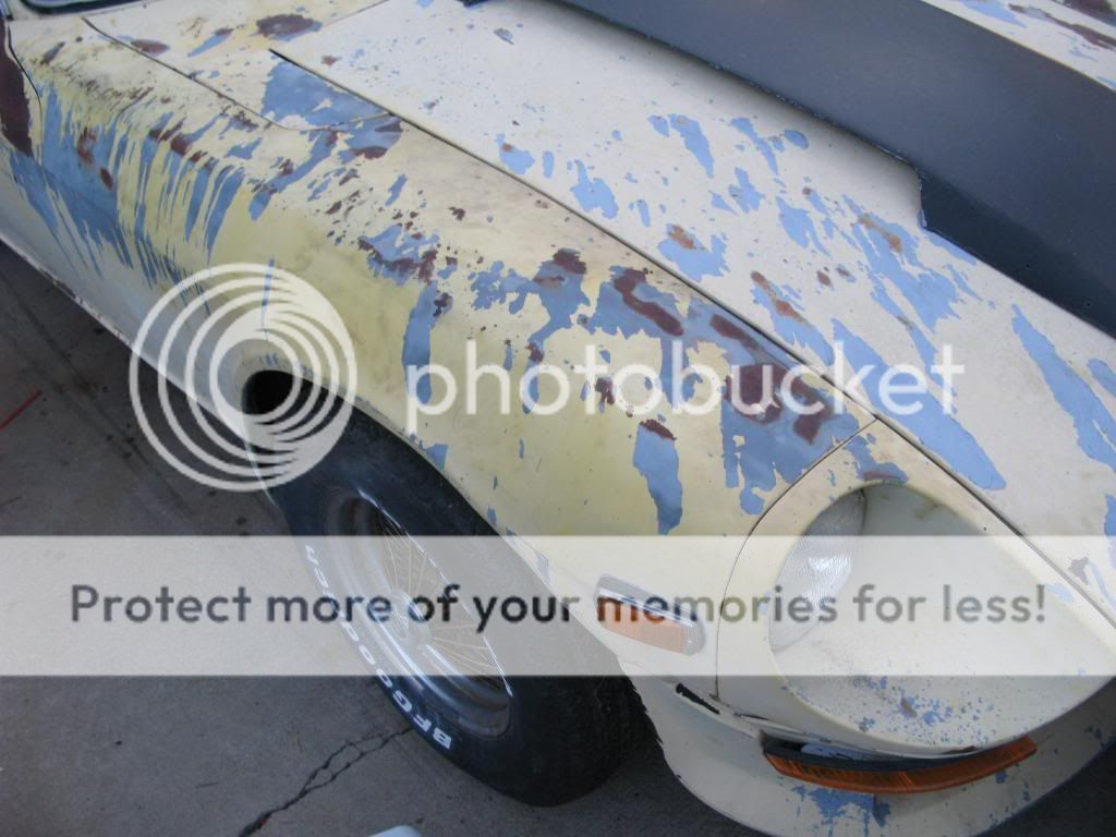

240zKidd Posted October 31, 2008 Share Posted October 31, 2008 Yesterday i went to pick up my 260z. It has been sitting for 20 years in Colorado climate.... The person who owned it before me died and his brother let it sit in his farms field... I got my hands on it... I barly know were to start... I drained oil looked new surprisingly... did full tune up spark plugs, spark plugs wires. distributor cap, I took the headers off and blasted exhaust out to make sure i had flow... put sea foam in all 6 cylnders haven't put spark plugs in yet... But I could not get the motor to crank it is seized up, The guy told me it ran when it was parked... So I know there hope... WHat all can i do? I have taken the starter off pryed on the flywheel and the timing gear at differnt angels... The cam moves a little to the slack of the timing chain but the bottom end is seized... What all can I do? To get the motor unstuck? The guy told me his brother bought the car brand new from the dealer... WIth the sports package or what ever for the better suspension... Is there any way to tell? And the car is a automatic how crappy are the automatics of this era...? is has bf goodrich tires p245 60r14... there huge and thick and bald as a slick... the front tire have a lot of tread just dry rotted.... the car has m ost of its emission off headers... dual sun roof. whale tail... Are the 260z fast? in comparsion to the 240 or 280...? Car has little to no rust just surface.... but has a front spoiler and wide stance in the back for the bigger tires... in the condition of the motor and every thign the odometer reads 26k.... which is belivable with the condtion of parts.... Is there anyway to tell once iget the motor to crank over? Sorry so many questions I am just figuring out what i got. Any information or help would be nice thank you Quote Link to comment Share on other sites More sharing options...

LowCarbZ Posted November 1, 2008 Share Posted November 1, 2008 That looks like quite the project. If it's been sitting on that damp grass i'd be checkin for the rusties big time. Quote Link to comment Share on other sites More sharing options...
blue72 Posted November 1, 2008 Share Posted November 1, 2008 Also of note, no 240, 260 or 280Z came with a sunroof from the factory. Aftermarket sunroofs aren't exactly known for good sealing abilities. That coupled with the 30+ year old weatherstripping on the car would have me looking at the floorpans to make sure the old carpet wasn't keeping moisture bottled up eating away at them. Also, the 26k on the odometer could be 26,000 or 126,000. This was before million mile odometers. Quote Link to comment Share on other sites More sharing options...
slownrusty Posted November 1, 2008 Share Posted November 1, 2008 I agree with everyone on here! I was going to buy a Z in Denver similar to that one you rescued, similar story as well (but different car) it had been sitting for 10years in long grass. It had a some great aftermarket wheels, flared arches (like yours) and an aftermarket sunroof and looked very rust free. Low and behold the crap aftermarket sunroof had leaked over the years and the carpet was very damp (first bad news)..then sure enough I peeled back the carpet and floors were all rotten - sadly. It was more of a project I wanted to tackle at the time. If the motor refuses to turn over with a 27mm socket on a 1/2 breaker bar, you are looking at more than likely a seized engine. Look at the Denver Craiglist, there might have a listing for L6 running gear you could get for cheap. There are lots of talented Z guys in Denver so you have lots of support and help locally. Good luck to you. Cool rescue and you can tell someone spent alot of money on that car back in the day based on the integrated flares, the aftermarket wheels, the body kit and the sunroof (which I hate sunroofs on these cars). Keep us updated. Regards - Yasin Quote Link to comment Share on other sites More sharing options...
