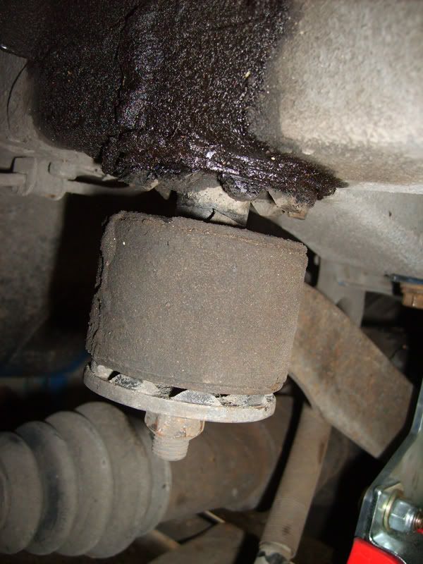

COmputoman Posted November 13, 2008 Share Posted November 13, 2008 I hear a clunking noise when my rear end exits a steep driveway or goes over a speed bump. Should the mustache bar mounting points be tightened up against the chassis? here is a photo of its current position. Also I just replaced the shocks and springs. Thanks for any advise! Ben Quote Link to comment Share on other sites More sharing options...
zedman240 Posted November 13, 2008 Share Posted November 13, 2008 I'd check rear shocks/struts before diff mount. Diff clunks are mainly heard when accelerating/braking. Check the top hats and anything else to do with the struts. Quote Link to comment Share on other sites More sharing options...
TrumpetRhapsody Posted November 13, 2008 Share Posted November 13, 2008 There's not supposed to be a space like that between the mustache bar and top bushing... it looks to be loose. Quote Link to comment Share on other sites More sharing options...
DREW RBZ Posted November 13, 2008 Share Posted November 13, 2008 That gap should not be there. If I were you I would replace the stock rubber bushings with a new set of poly bushings and tighten it up...will make a big difference. Check your differential mount while you are at it and replace if cracked/broken/worn...The poly mustache bushings are available from various companies...here is a set on Ebay..there are other suppliers. http://cgi.ebay.com/ebaymotors/DATSUN-240Z-260Z-280Z-Mustache-Bar-Bushings-14-1602-BL_W0QQcmdZViewItemQQ_trksidZp3286Q2em20Q2el1116QQitemZ360021913084QQptZMotorsQ5fCarQ5fTruckQ5fPartsQ5fAccessories Quote Link to comment Share on other sites More sharing options...
COmputoman Posted November 14, 2008 Author Share Posted November 14, 2008 Thanks a lot guys. Ill be sure to change those bushings once I do my diff swap soon. Until then I will try to tighten it down a little and see if it clears anything up. Ben Quote Link to comment Share on other sites More sharing options...
rags Posted November 14, 2008 Share Posted November 14, 2008 Go back to the speedbump where you heard the noise. Go over it again with your foot on the clutch. If you hear the noise while freewheeling over the speedbump the noise is coming from the struts. You said you just changed the struts and springs. Was the noise there before you did this? Are you now using shorter lowering springs? Quote Link to comment Share on other sites More sharing options...
blue72 Posted November 14, 2008 Share Posted November 14, 2008 Should be snug I'd say. I can't say I've personally seen mustache bar bushings like those before. Here's a picture of a '72 and '76 bar for reference. Quote Link to comment Share on other sites More sharing options...
Silver Mine Motors Posted November 15, 2008 Share Posted November 15, 2008 Hey i just had that same problem this past week and I also though it was the shocks but, when I put the car on a lift it was my sway bar mounting bracket. The bracket broke were it holds the sway bar the to frame of the car. I would check that and just weld it back if that's the case. Quote Link to comment Share on other sites More sharing options...

batou Posted December 9, 2008 Share Posted December 9, 2008 The rubber bushings on my 76 also have those v notches cut out of em. Quote Link to comment Share on other sites More sharing options...
