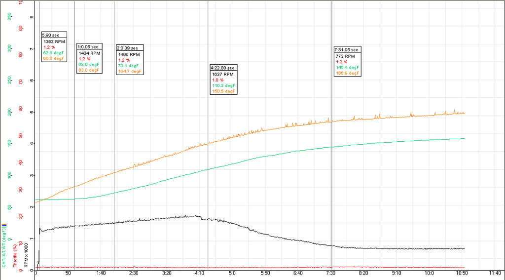

Administrators RTz Posted November 26, 2008 Administrators Share Posted November 26, 2008 I think you have a few things going on... Firstly, cold idle, useing the 'widget', should be higher than 8-900. By the time it closes down, there won't be enough air for a stable idle. If I set my car to cold idle ~1400, warm idle settles in nicely at 680 to 700. Secondly, the widget should not be closeing down as soon you start the engine. That will cause the valve to close prematurely in the winter. I normally set it to begin closing down at 100F water temp. I find this to be a nice compromise between winter and summer months. Chart below shows a nearly complete warm up cycle. Black trace is RPM, green is temp, and red is TPS. Ignore the orange trace. The air reg. closing is very clear (at 4:10)... Lastly, as you noted, manifold pressure is substantial when the valve is open (and changes throughout the warm up cycle). It does take some fiddling to get this 'right'. You'll need to pay close attention to the active cells during warm up if you want a 'factory like' result. Quote Link to comment Share on other sites More sharing options...
mikeatrpi Posted December 3, 2008 Author Share Posted December 3, 2008 Ron, thank you. I adjusted the cold RPM up from 900 to 1400. Cold that day was around 44 degrees F ambient temp. It now settles down to around 850-900 once warmed up. I will work on it a little more so it settles down around 700 or so RPM. Would you say 680-700 is an ideal idle RPM for the L28? Now the datsun air regulator (aforementioned widget) is completely independent of the megasquirt. It is supplied with 12v switched from the fuel pump relay. This power heats a wire coil, causing a trap door to close thereby cutting off air as the wire heats. Anyway - I can't set it to open or close at a specific temp. Here's a data log and MSQ. It starts at the end of my warmup... RPMs are in the 1000 range and slowly settle to 850ish. I think the thermostat must have opened up because I see the CLT (the datsun CHTS in my case) drop significantly. Now - at the very end of the log, the car stumbles and stalls. It looks like it goes into accel enrichment mode briefly at the very beginning of this. I'd appreciate any advice. As a side comment, I can't rev over 3500 RPM. If I do, the RPMs spike. I believe that's an SI / noise issue on the VR line from the distributor. I mention it here incase its relevant. msq_idle.zip Quote Link to comment Share on other sites More sharing options...
