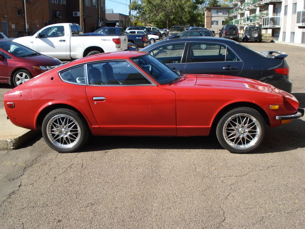

Lukaniuk Posted December 5, 2008 Share Posted December 5, 2008 I'm running 17X7 with spacers and 215/45/17s. Car is the stock height, but the wheels will rub a bit when I'm backing up and really crank it a long way to the side. Quote Link to comment Share on other sites More sharing options...

janaka Posted December 11, 2008 Share Posted December 11, 2008 These are trevor's wheels. Quote Link to comment Share on other sites More sharing options...
Lukaniuk Posted December 11, 2008 Share Posted December 11, 2008 Quote Link to comment Share on other sites More sharing options...
bco6 Posted December 11, 2008 Share Posted December 11, 2008 Here is a pic of my 240 with MSA spacers, eibach lowering springs, and 17X7 with 225/45/17 they work great, no rubbing! Quote Link to comment Share on other sites More sharing options...
Challenger Posted December 12, 2008 Share Posted December 12, 2008 What is the thickness on the spacers? 35mm? Quote Link to comment Share on other sites More sharing options...

cockerstar Posted December 16, 2008 Share Posted December 16, 2008 Trevor, those wheels look excellent. Definitely one of my favorite wheels on a Z, although I might go with a little thicker tire if it fits. Maybe a 55 on the aspect rastio or so:) bco6, those are also very, very nice. Which wheels are they? I'm interested in the size of the spacers each of you are running to get them to fit properly. Quote Link to comment Share on other sites More sharing options...
