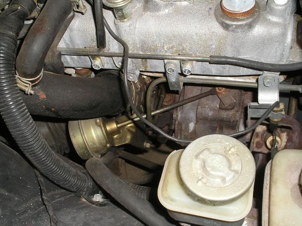

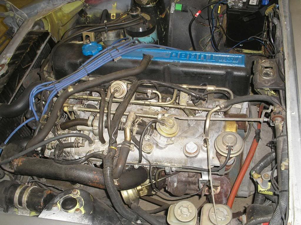

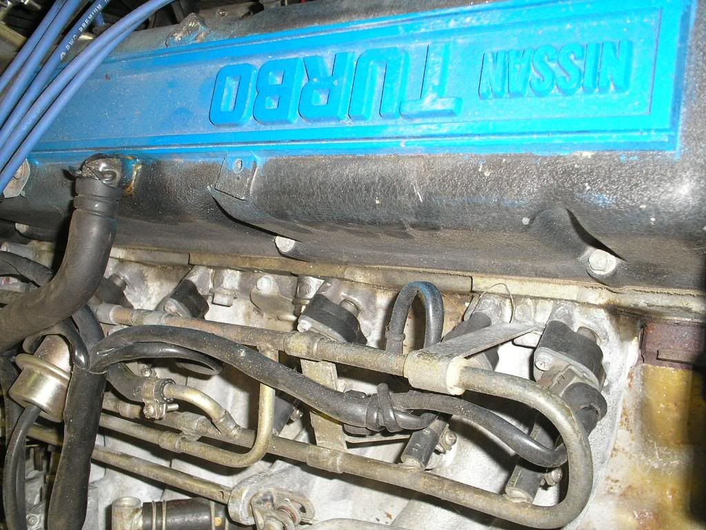

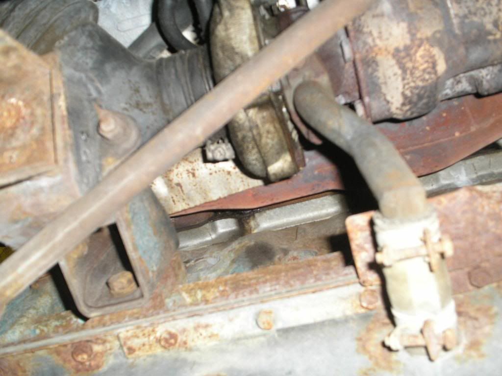

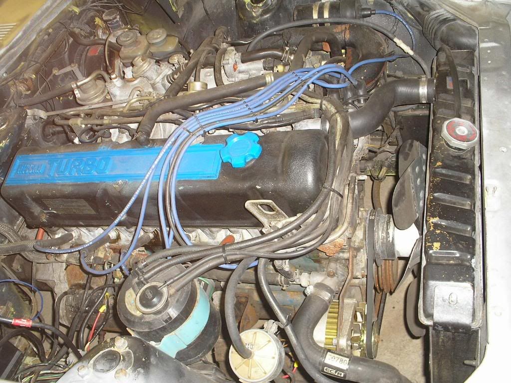

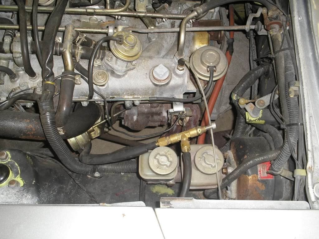

Maybe post up some pics of the turbo. Tell us about the vacume routing from the wastegate actuator. You need to find out what injectors you have also. Is the exhaust stock also I wonder? Does the engine harness look to be in good shape or are there broken connectors and exposed wires?

can any one tell me what type of injectors they are? or do i have to take them off and compare photos with the injector thread? Secondly i ordered a wideband and i will need to install the o2 sensor, can I pull out the existing o2 sensor and put in the new one? or will that mess up the ecu and cause the car not to run?
I see a hint of brown on the injectors, They are most likely stock turbo injectors. As for the wideband. You will need to get to the muffler shop and have a 02 bung welded in at least 10"-12" away from the turbo. Too close to the turbo and you will burn that expencive wideband sensor up. The car looks great man!. Do you know what AFR's are good and what AFR's are bad for WOT? what you are looking for on 93 pump gas on a turbo car is around 11-7 to 11-8 AFR's. what kind of wideband did you go with? I would also suggest a nice front mount intercooler, much better flowing downpipe and 3" exhaust in your quest for more power. I noticed a huge difference when I was running stock electronics and 10psi of boost from when I added the Intercooler.

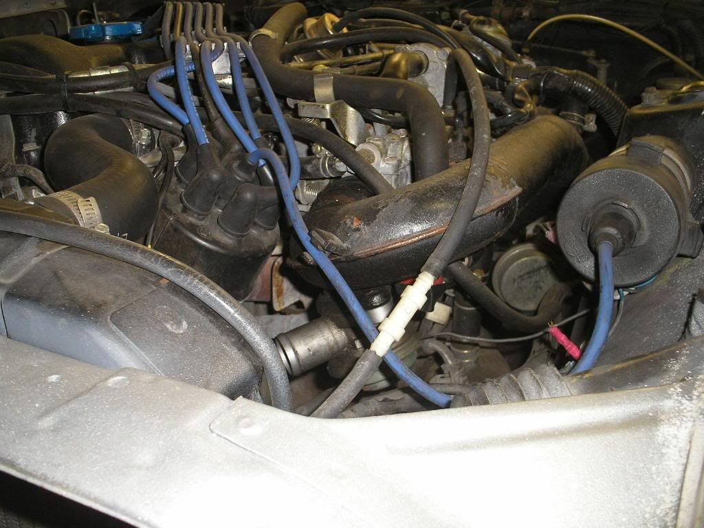

I noticed a Mitsubishi Eclispe Blow off valve and flange welded to your intake piping. That is the sound you are hearing when letting off the throttle after boost, the BOV outlet really needs to be plumbed before the airflow sensor.

you cant plumb it before the afm on this car. Only when the AFM is being boosted through can you do that. It is just goung to get a rich condition under shiftes. It will live.

last week was finals week so i had some free time.. I read maximum boost and did a ton of research. and found my vacuum controlled manual boost controller tucked under the master vac. now which direction turns down the boost? screw it in or screw it out?
I would not suspect the rings on 4 and 5. I would suspect the spark plugs are not tight in the head. any readings on that wideband yet? I sencond the opinion to remove the boost controller all together for now. You need to run a dry then a wet compression test on all 6cyl to get a resonable idea of the condition of the motor.
