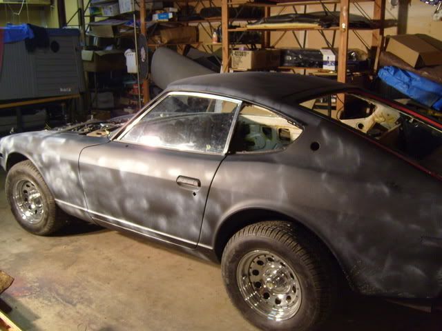

Next was the body work. I started by sanding down the original paint, and filled the side-strip holes with a thin layer of bondo.
I shaved the holes in the rear by covering them from behind with fiberglass then filling them with fiberglass re-inforced bondo, then bondo to smooth in all out.

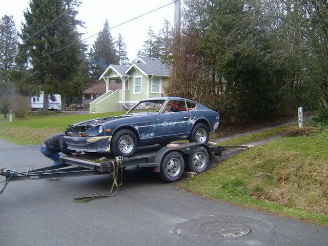

Getting a low z car onto high trailer....Take I *actually ended up finding out that trailers make great see-saws when not hitched properly* oops
Take II....had to think this time. Used a nearby driveway to get the angle right.
