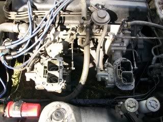

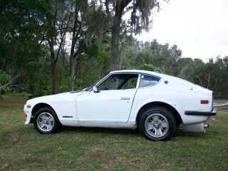

So I’m new to this whole datsun thing hell I’m new to imports all together, I have been diehard Chevy since birth. I’m also new to the forums because the domestic forums are nowhere near the same level u usually end up wasting your time to register and login, but my brother is big in the Mazda rx7 forums and he lives by them. I recently purchased a 1973 datsun 260z for $450 filled with a bunch of parts that I am going to be getting rid of to help pay for the building of the car. My original plans were to swap out the motor and put in my built 350 small block but after driving the car with the light little motor in it and feeling how well it handles I’ve decide to swap to a fuel injected turbo motor ( ka, sr. or rb) haven’t decided. looking for any insight anyone wants to throw my way, anything that looks wrong or any suggestion of swaps, good websites for parts, ANYTHING

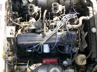

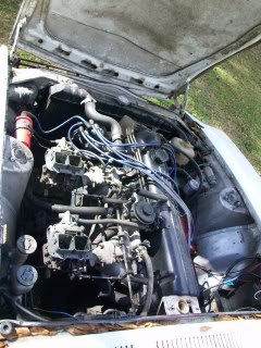

Well, insight number 1: If your car is a 73, then it's a 240Z, not a 260, which were only sold in 74 (in the US). Either way, your carbs are not factory original; they are Weber downdrafts, which were commonly put into 73 and 74 cars to replace the horrible factory original smog control carbs.Anyhow, enjoy the car; I'm always partial to keeping the stock inline sixes in them, although putting in a smallblock with aluminum heads and moving the battery to the back keeps the weight and handling just about the same.
It's at least a '74. Just look at the taillights. I'd say early style '74 260Z because of the thin bumpers. It's still got the N series intake manifolds and late flattop carb 3 line fuel rail, so some previous owner probably switched to the DGV's to be rid of the flattop SU's.

well if the door stamp says 73 it's a 73. Back in the day when your car was sold, it wasn't unusual to list the year of the sale date on the title, so I would say your car was a 73 sold in 74.
There was a change in the middle of the 74 model year and I have seen some strange mixes of parts in the 73's and 74's....you can't just look at the fuel rail and tell when the car was made.
The big difference is the motor, obviously. The cam in a 260 motor was slightly hotter than the other stock cams, and of course it had bigger displacement.
It's true that in certain states they were registered that way instead of based on model year. It sounds like a late '73 production, '74 model year 260Z. It is most certainly a 260Z though.
It's also true that you can't tell the year just by looking at the fuel rail, especially seeing as mamba 888 just posted a week or two ago trying to find info for the three line rail in his '73 model year 240Z.

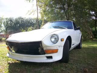

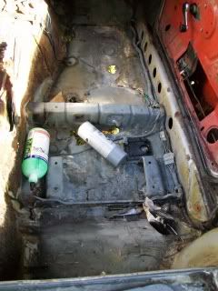

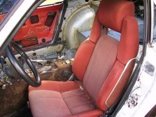

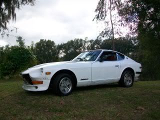

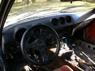

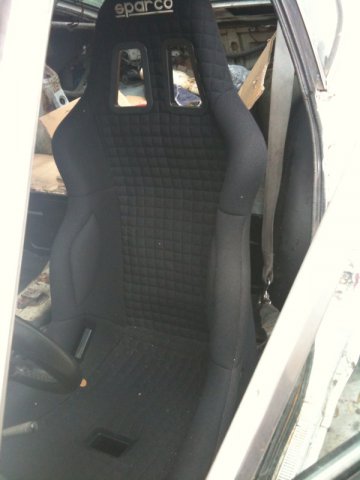

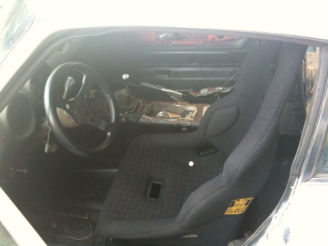

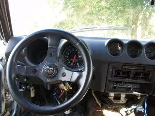

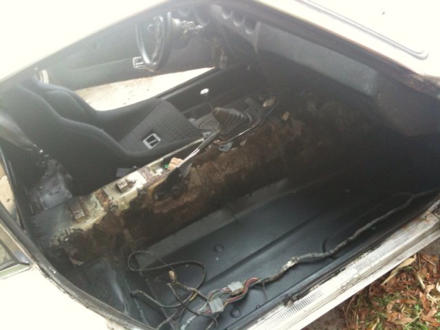

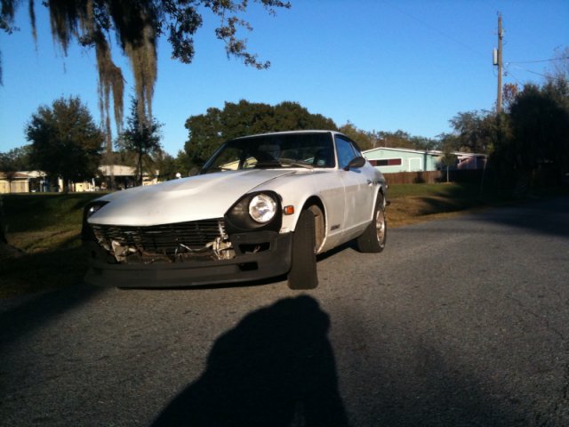

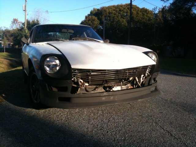

here a some recent pictures.
added a front airdam (it was broken)
added metal headlight buckets (other ones were broken)
welded in floorpans
mounted sparco seeat

Looks pretty good for $450, nice find. Is that the MSA or xenon airdam that you added? Is is fiberglass or the flexible urethane? I am interested to see where this car goes. Are you going to keep it white or go for a different color?
Elliot
yeah its a urethane airdam i picked up off the forum. im planning on going with a olive drab paint jobpost-5011-12678895491578_thumb.jpg
Also shifter bushing is absent so the shifting is like a stick in a bucket. I’ve read post on using door bushings as shifter bushings but I didn’t understand. How do I remove the shifter and do I have to modify the bushing or do I just slip it on and slam it back in.
The shifter is held in by a pin with a circlip. Pop circlip from one side, push out pin, remove lever. It may take a teeny, tiny bit of force to pop out of the cup on the trans. Go to autozone and get the HELP! series of brass bushings. Find one in the package that's close. I needed to turn down both the ID and OD of the brass bushing itself as it was too big to fit into the shift lever hole and the pin was too big to slide in.
I don't have a lathe but I found a drill bit that was a tad smaller than the ID, wrapped it in E-tape, forced the bushing over the tape, turned on drill and used a jewlers file to reduce the OD. After that, I hammered it into the lever (with a plastic mallet) for a tight fit. I then reamed out the ID with a dremel cylinder type cutter until the pin slipped in. MUCH better than a 40 year-old plastic bushing
