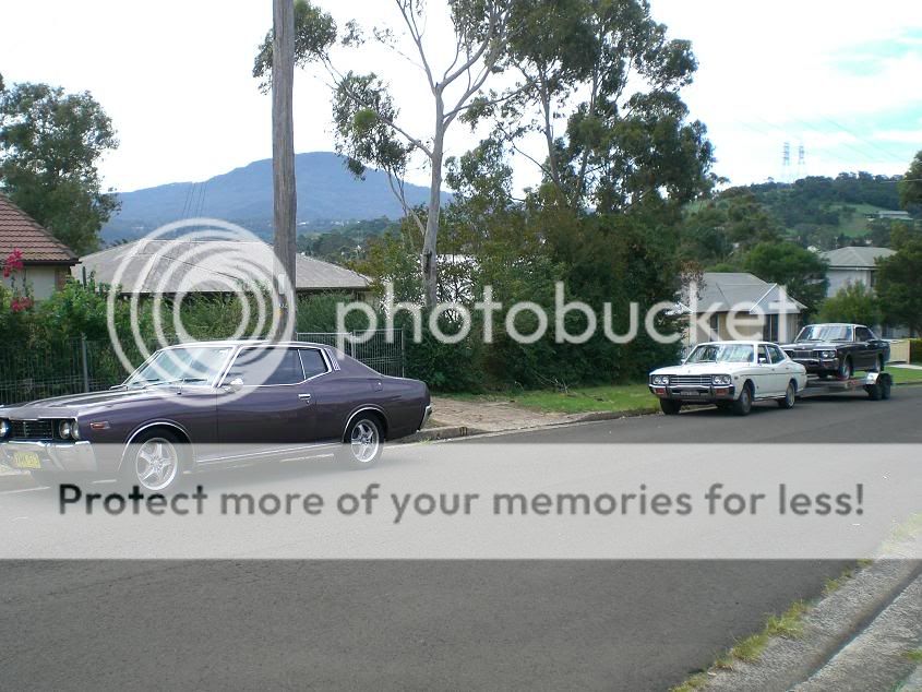

kolonelklink87 Posted March 14, 2009 Share Posted March 14, 2009 Here is a possible reason why you might want to go down this route...(though, i concede, in this instance it's a bit of a self-fulfilling prophecy). Thats ozcon's l28(NA!) pulling a JDM cedric and trailer with a combined weight exceeding 2000kg... not bad if you ask me. We took it on the freeway up to 100km/h, uphill, downhill, left right center... no issues. This thing is HEAVY. so many memories... (mmm... cedric convoy) Quote Link to comment Share on other sites More sharing options...
ozconnection Posted March 14, 2009 Author Share Posted March 14, 2009 I guess this illustrates the versatility of the L Series engine nicely. The Cedric may not be a fast car because of body weight and engine specification. The camshaft profile may limit how quickly the engine accelerates to redline but it's the same camshaft that allows this sort of towing capability to take place. You should 'feel' how toey the car is now since towing that lot. Feels like a rocket ship The L20A head has been reworked and I'll be picking it up on Monday. Some pictures to follow soon. Cheers. Quote Link to comment Share on other sites More sharing options...
HowlerMonkey Posted March 15, 2009 Share Posted March 15, 2009 Sweet........I towed a first generation maxima with a 280zx. Quote Link to comment Share on other sites More sharing options...
Tony D Posted March 15, 2009 Share Posted March 15, 2009 I puked squid tentacles, baby octapus, and raw fish out the right rear window of a car that looked exactly like the cream coloured one with the trailer attached! That car had an L28 with Triples and a Five Speed conversion eventually...yeah, it burned up clutches something fierce when you tried to drag race it. I think there is a reason the saloons got totally different intake manifolds later in the production run---the standard manifold just wasn't cutting it. And in each instance, the runners went smaller, not larger. It was for the application as those manifolds never appeared in any Z-Car from the factory. Only the heavier bodied saloon cars and behemoths I used to call 'Japanese Impalas' That cream car have the rear seat radio option, where the back seat passengers could listen to a different station than those in the front? Talk about 'made for Taxi Service!' LOL Yeah, those are some memories there! Man that octopus was vile coming back out... Quote Link to comment Share on other sites More sharing options...
