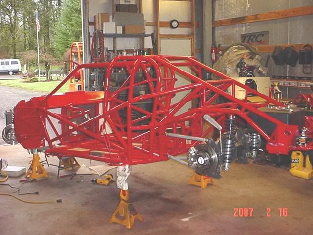

sweetride2go Posted January 21, 2009 Share Posted January 21, 2009 POR-15 makes a product called Hardnose. We painted a tube chassis with it and it looked great. Unfortunatly it didn't hold up near as well as we hoped (chipped easily). I would recommend trying the epoxy paint, we have used that with better results. Oh, and sanding tube chassis' is a pain, literally, hah... Here is the chassis, beginning assembly... Sorry for the poor picture quality. Cheers ryan~ Quote Link to comment Share on other sites More sharing options...
