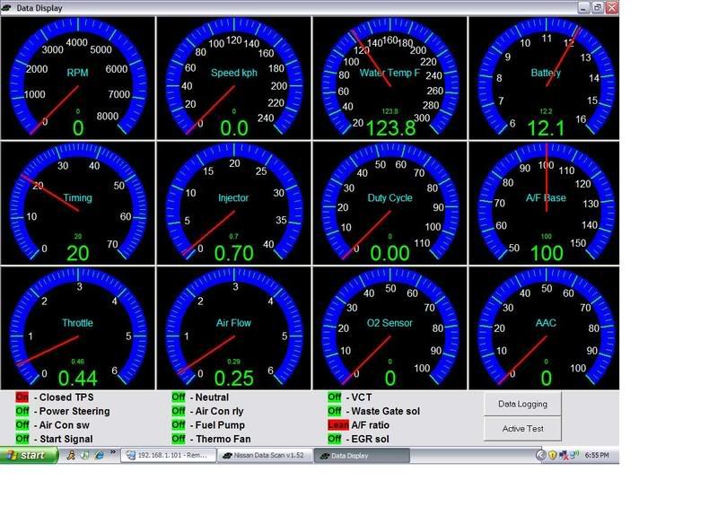

jtmny1999 Posted March 2, 2009 Author Share Posted March 2, 2009 With key on i can see all the guages, water temp, tps voltage, timing everything works fine. Quote Link to comment Share on other sites More sharing options...

jerryb Posted March 3, 2009 Share Posted March 3, 2009 What happens when you try to reconnect after you lost the signal? Also, try running the dashboard with just two gauges. If you select a parameter that is sending a "bad" signal NDS will disconnect. I will be on...... Quote Link to comment Share on other sites More sharing options...
jtmny1999 Posted March 3, 2009 Author Share Posted March 3, 2009 jerryb said: What happens when you try to reconnect after you lost the signal? Also, try running the dashboard with just two gauges. If you select a parameter that is sending a "bad" signal NDS will disconnect. I will be on...... I am at work right now, but when I tried to connect when the car is running windows wont recognize the device. I don't think its the software, i look at device manager and the com port will dissapear. Quote Link to comment Share on other sites More sharing options...
