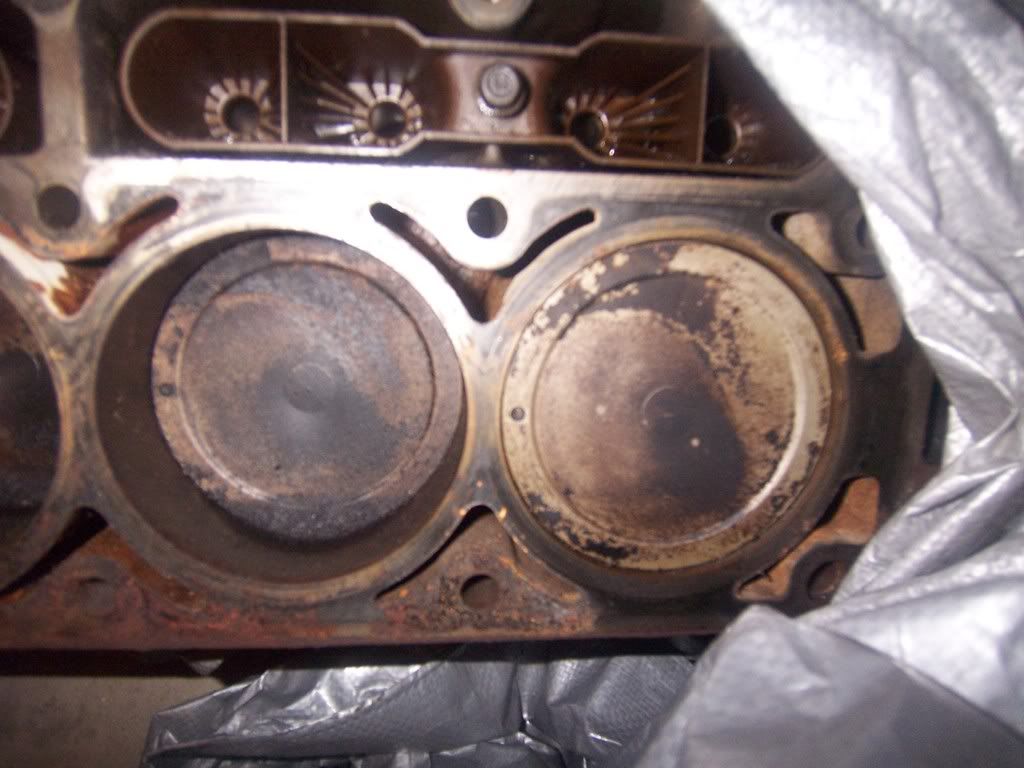

roger280zx Posted March 25, 2009 Share Posted March 25, 2009 Roger: I am always interested in experiences concerning grooves. Did your fathers 283 have grooves in the cylinder heads. If so please describe. More about the "Flame Trails" if you can. I have seen pictures of heads that have the groove and been run and they appear clean. Maybe that was because they were not run for an extensive amount of time? Honestly, I doubt there are pics anywhere of that engine. It was all I could do to find a couple of pics of the car. I wish I knew more about it, but the car was smashed by a Ryder truck when I was five years old, and by that time the 283 and 4 speed were long gone in favor of a family man's 327 and th400. All I do know is that the old man who built the engine had quite a reputation and EVERYONE my dad knows talks about standing a nickel on end on the air cleaner and spinning the thing to 8000 rpm without the coin falling over...WOW! Quote Link to comment Share on other sites More sharing options...
