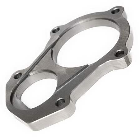

240Z_Master Posted March 24, 2009 Author Share Posted March 24, 2009 I was looking something more built into the turbo housing... Quote Link to comment Share on other sites More sharing options...

240Z_Master Posted March 25, 2009 Author Share Posted March 25, 2009 I'm a fan of the one I posted because it has a divided flange to keep the surge down from the wastegate to the exhaust wheel. Anyone agree? This still doesn't answer my question if anyone knows any hookups for Garrett Turbos. Quote Link to comment Share on other sites More sharing options...
boardkid280z Posted March 25, 2009 Share Posted March 25, 2009 I'm a fan of the one I posted because it has a divided flange to keep the surge down from the wastegate to the exhaust wheel. Anyone agree? This still doesn't answer my question if anyone knows any hookups for Garrett Turbos. Hehe, sorry for threadja... I mean sidetracking your thread. I found this site when I was looking around for info on Garrett's internally gated GT30Rs. Looks like a pretty good deal, compared to other places. $1200+$125(I.W.) http://www.cimotorsports.net/motor-sport-products/garrett-gt3076r-turbocharger.html I don't know if there any distributors who give HybridZers discounts on those, especially if you're looking for a genuine Garrett turbo. Cool flange, I guess you'll be making you're own downpipe with that exhaust housing. How far down will you reintroduce the wastegate gas? I have seen them put back in anywhere from 3 inches to 3 feet down from the turbo. With that adapter, you could make your own divorced downpipe and I've seen them where people reintroduce the wastegate exhaust 2 feet down from the turbo, some more, some less. Farther from the turbo, the gas is less turbulent and the reintroduction causes less backpressure increase. I believe this is what you were interested in. Something like this: (originally posted by jgkurz) But of course without the external wastegate. Here are a couple of threads I found about downpipes with wastegate piping and internal vs external discussions: http://forums.hybridz.org/showthread.php?t=125955&highlight=downpipe+bolt http://forums.hybridz.org/showthread.php?t=136938&highlight=downpipe+bolt I would say I would agree with your approach on keeping the wastegate gases away from the turbine exducer to improve flow, that is the one thing I am concerned with on the Ultimate Internal Wastegate that Brad and I were talking about. You're choice does seem to address that issue, and I assume it would flow more without that additional turbulence. I wonder if the size of the wastegate hole is any different. Quote Link to comment Share on other sites More sharing options...
