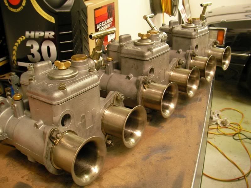

Babalouie Posted April 13, 2009 Share Posted April 13, 2009 $700 is a lot. I had a set of triples rebuilt for $450 (Australian dollars) and that included bead blasting the castings to make em look nice again. Before After Quote Link to comment Share on other sites More sharing options...
