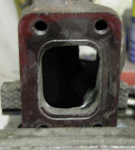

jeffp Posted June 18, 2009 Share Posted June 18, 2009 I have run the car on that dyno, not bad. I liked the idea that I could see the whole running gear in action. I don't however like stressing the rest of the dive assembly if I don't need to. The cooling will be much better on the engine dyno. That is what I am really working the cooling for high hp sustained operation. I like the idea of continious drag on the engine, very similar to what a boat engine is subject to. That is the very best way to tune, because now you have the ability to increase, decrease fuel and timing without the "car" getting hot. I need to keep the engine cool and the higher the hp the increased heat is becoming an issue, so much so that I am working on some changes that I think just may be helpful before I try for high hp levels. I have blown a forged 3.0 block, and I think like Bo a stock bottem end block. The car sits a while until I get the cylinder head completed. This is what I worked on tonight. The EURO manifold. Quote Link to comment Share on other sites More sharing options...

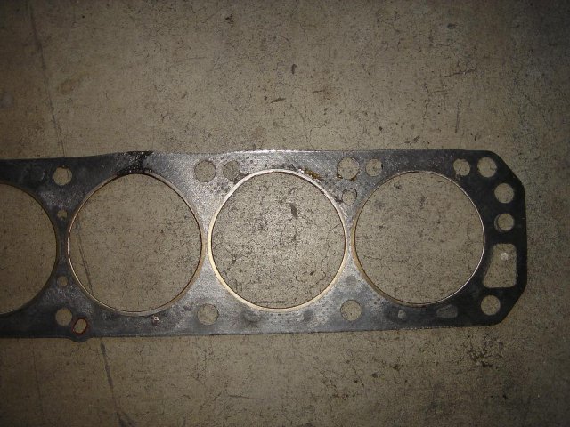

Gixxer Squid Posted July 19, 2009 Share Posted July 19, 2009 (edited) Just read this post and sorry to hear about your engine issues. As you may know I just got my car back after detonation and dropped #4 valve seat. Just spent $3200 for all work, larger fuel lines, installation of meth kit, larger turbo cam shaft and some other upgrades. Put it on Dyno after having it one week to get AFR right, blew it UP! Have not pulled head yet but know I dropped another retainer on the intake side #6. as the lash pad fell off when I took the valve cover off. The whole purpose of the meth was to cool things to run higher boost. Did not even have the chance to turn boost up. Not to hijack Bo's thread but some interesting points are brought up. 1. That headgasket could have been part of the problem, thats the same one I had before I had the latest rebuild. 2. Top of your pistons were pretty black, the meth should have kept the carbon deposits pretty darn clean should it not. I have been toying with idea of doing a 3.2 turbo stroker, after reading this thread and the potential loss of HP 175+, obviously I would be going in the wrong direction it seems. There is no turning away from turbo though. Is is possible to build to even build a RELIABLE inline 6 to run at 450 hp give or take at 12-14 psi or so. I had the car set at 20 psi. meth came on at 6 psi to full spray at 15 psi. Considering possibly adding EGT sensors to #2 and #5 during rebuild. Comments. Just seems to me that once you go over 15-18 psi boost that you better have an endless supply of $$$. I think it rather odd to drop 2 new steel retainers on a brandnew engine. Although head gasket and everything held up this time I cant help but think that the sonic waves from detonation is screwing up my retainers causing them to drop. WB sensor though just does not show the temp inside the combustion chambers. Almost kicking myself for not throwing the 383 stroker motor I was originally going to put in. Wanted to keep with the inline 6 originality theme. Confused and frustrated beyond belief. Also: boost hit 18 psi quickly but creeped up to 20 psi in 2-3 seconds, think boost controller needs to be upgraded, suggestions? Edited July 19, 2009 by Gixxer Squid none Quote Link to comment Share on other sites More sharing options...
Gixxer Squid Posted July 19, 2009 Share Posted July 19, 2009 Well, I've had a run of "luck" over the past 1.5 years and managed to only blow head gaskets. My luck just ran out it seems. I blew a headgasket along with the ring(s) on cylinder 3 for sure and maybe more. Detonation damage for sure. I dont know Bo, your boost with meth/h20 is really not all that high. guys running 30+ is high but i do not find what u were running all that extreme unless these engines are not capable of sustaining the heat for extended periods of time, unless these inline 6's are just not as reliable as well all think they are . h20 has no octane rating. Quote Link to comment Share on other sites More sharing options...
