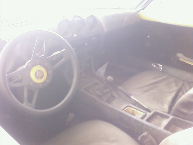

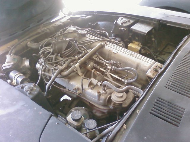

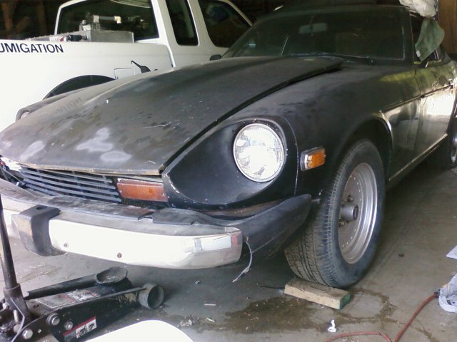

Earlier today I picked up a 1975 Datsun 280z for little more than a song. It appears bone stock except for a set of aluminum vintage Enkei 14" wheels (they look just like old school 2-piece Centerlines). It also has the factory R200 and optional 5-speed tranny.
So, the plan is to yank the low mileage 5.3 LSx (from a 2004 Escalade) and 4L60e (from a 2004 GTO) from my '69 Chevy C10 and transplant them into my newest edition. The EFI combo is already to go since it was modified for stand-alone operation.

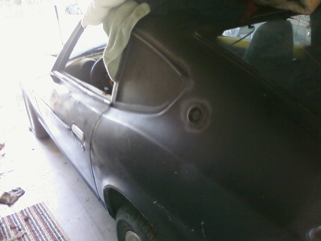

Just like BBZ, LSZ's body will be shaved of all chrome side trim, marker lights, emblems, antenna hole, etc. Although I might add a GM emblem 'LSx' to the fenders or hood after paint in the distant future. Also is the return of BBZ's 4" cowl hood. BBZ's owner doesn't care for it, so we've made an arrangement for me to purchase it back. The cowl hood will hopefully allow me to keep the truck intake (for the time being) and still close the hood. I also might add a BRE style spoiler, time will tell.
Unlike BBZ, I would like to keep a 'stock' feel with the interior with LSZ. BBZ was more toward a race type interior down to no carpet, coverless racing shifter, and Auto Meter Sport-Comp gauges throughout. I think this time I'll keep LSZ with the stock gauges (albeit modified for use with the LSx electronics) and most of the stock type interior minus an aftermarket shifter and stereo.

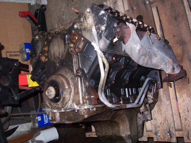

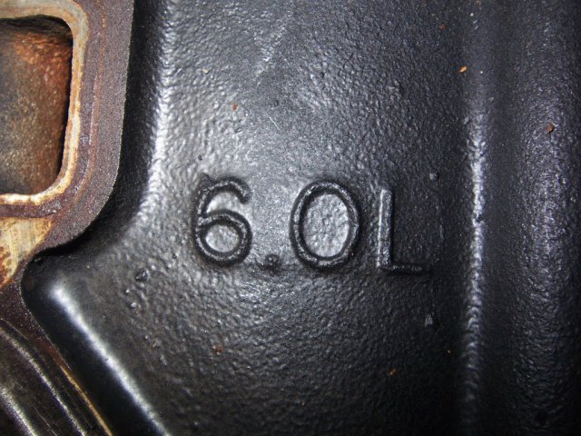

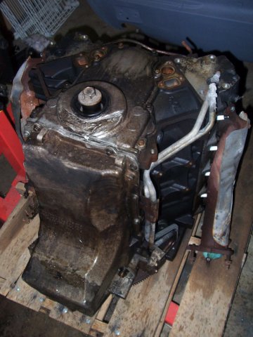

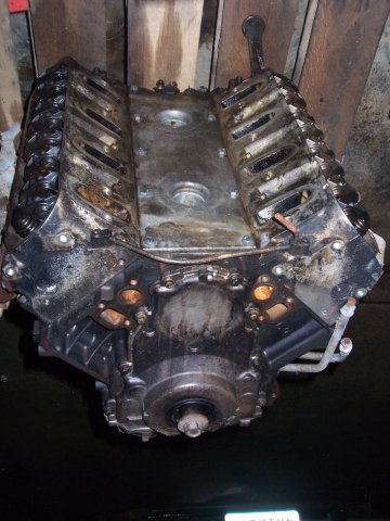

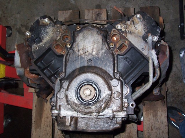

Looks like I am going with a LQ4 6.0 afterall. Its just a long block, the donor it came out of was in a fire and cooked the intake, sensors, bearings, and some rust is now present in most of the cylinders. It needs a rebuild, but more or less the long block will remain stock. I'll still end up 'stealing' all the EFI stuff off the 5.3 in my truck after the 6.0 has been freshened up.
Another member is also selling me a low mileage '03 LS6 cam and springs, so that'll end up in there too for another 40+HP over the stock LQ4 cam.
If I get near 400 HP/TQ N/A I'll be a happy camper and so will my Z. Then the nitrous will be added down the road.

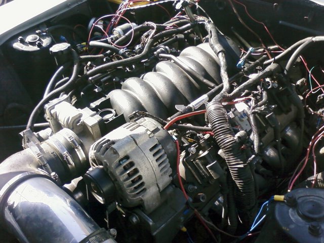

Are you still going to keep the lq4 intake manifold. I want to stick with that so that and all the stock pulleys and accessorys. Will that work? Of course i will be removing a/c and p/s. Our swaps are very similar.
Yes, I will be retaining the stock 5.3 LM7 intake (same as the LQ4/LQ9 intake). I haven't put the motor in the Z yet because I am still raising funds for the re-freshening (budget rebuild). Although I might just use the 5.3 LM7 for the time being.
However my buddy Miles has the exact same intake on his 240z and the truck intake and alternator/alternator bracket will not clear the stock S30 hood. Luckily for Miles and myself that doesn't matter because we both are using cowl induction hoods that give us the necessary clearance for both.
Thats good to know. Cause everyone else talks about changing over all the accessories. So i thought i was stuck with having to get all the ls1 parts. Thanks for the info. Im going to the junk yard today to get another hood and im probally going to just cut a hole in it for now. I'll keep you updated on my swap also. :lol:
A good reason to swap the accessories is because so many people sell the LS6/LS1 intakes because they upgrade to the FAST, or some other type of intake manifold.
Although this is true, the LS1 intakes will cause you to lose power over the truck intake (but are cheap) and the LS6 intake don't improve anything until above 6000+ RPM and are still fetching $450+ (used) w/o fuel rails/injectors/etc.
