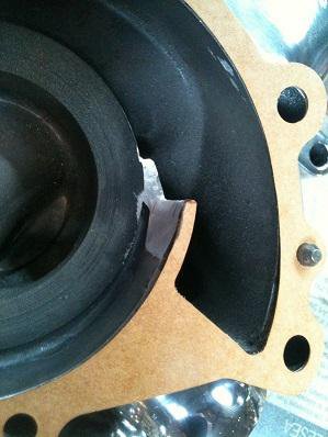

ktm Posted August 15, 2009 Share Posted August 15, 2009 I am rebuilding my engine now and am installing a LD28 water pump based on discussions in this thread: http://forums.hybridz.org/showthread.php?t=125186&page=3 I know I have to trim off the little piece in order for the pump to fit, but I had to trim nearly 1/2-in., not the 1-4-in. stated. The problem I encountered were the LD28 impellers kept hitting the timing cover sidewalls due to the shape of the spiral. How much did anyone else have to trim in order for the pump to fit? Now is the time for me to make any corretion such as getting a new cover and using the standard L28 pump. My concern is that the pump may not function correctly with so much cut. I cut just enough for the impellers to clear and no more. Quote Link to comment Share on other sites More sharing options...

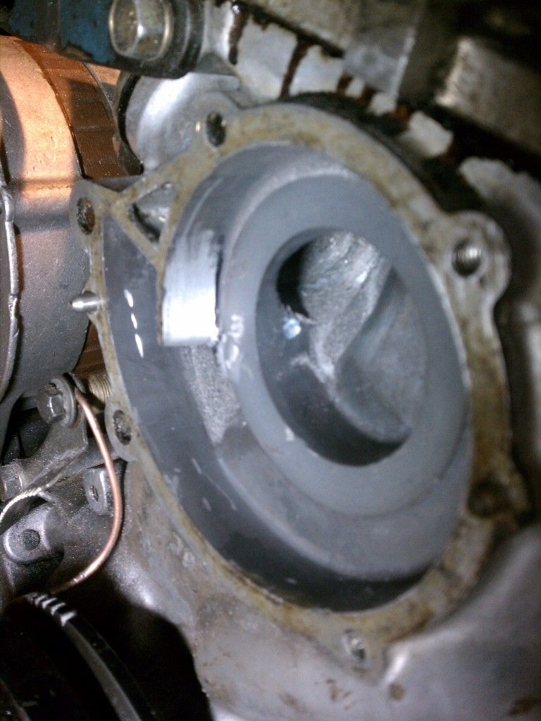

SleeperZ Posted September 28, 2012 Share Posted September 28, 2012 Modified the front cover to fit the pump. Chopped out the tip section, then smoothed the inside surface to clear the larger impeller. Quote Link to comment Share on other sites More sharing options...

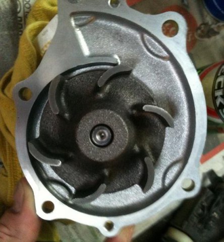

duragg Posted March 28, 2013 Share Posted March 28, 2013 Pic below. I pulled it myself off the LD28 I bought last week. My "LD28" pump and the pump I installed when I built the engine. It installs with no interference from anything so I will just proceed and run it. Quote Link to comment Share on other sites More sharing options...

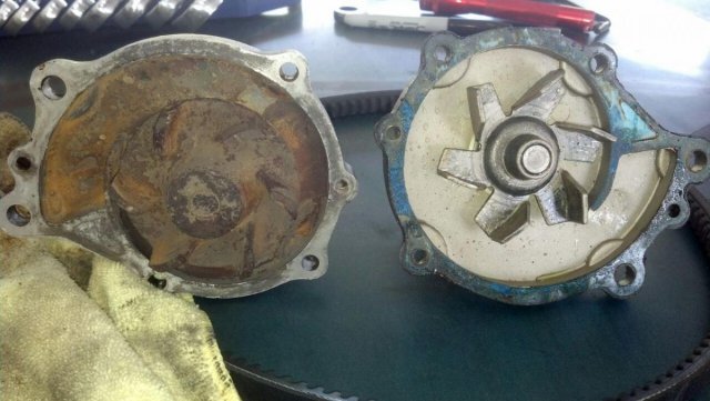

duragg Posted March 28, 2013 Share Posted March 28, 2013 Found some other pics of LD28 pumps with different little tip things. Maybe it is a cast gas. Wonder if its any better than the stock one I pulled out. Quote Link to comment Share on other sites More sharing options...
Xnke Posted March 28, 2013 Share Posted March 28, 2013 That's a stock gas-fueled pump....someone just bought the cheaper, more available one or the generic parts-store replacement. Quote Link to comment Share on other sites More sharing options...
duragg Posted March 29, 2013 Share Posted March 29, 2013 Well... one is old cast "Japan" pump Other is the cheap one I installed at build The "Japan" cast impeller was a bonus in the LD28 engine (complete) for $450 Quote Link to comment Share on other sites More sharing options...
