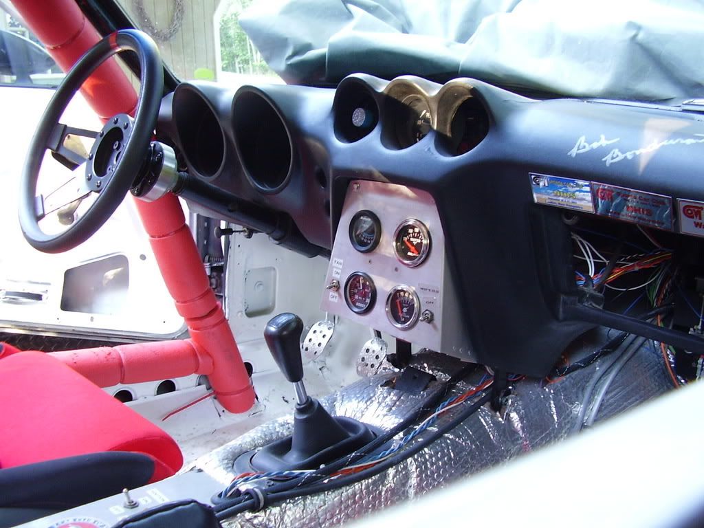

Once you replace the stock oil pressure and water temp gauges with decent full sweep ones, you'll need a place for a fuel gauge and amp/volt gauge (if desired)...
Yeah, I have my Fuel level, voltage and O2 (NB ugh) gauges where the radio should be.
I will be moving the gauges so I can once again have a radio, since I find on long drives at constant speed, the symphony of Intake and Exhaust, with special guest Turbocharger, just gets a little mundane. LOL
I just have to find a place or better way to have those gauges elsewhere, that doesn't put gauges all over the place and look bad.
Right now I'm rocking an iPod, with some cheap amplified computer speakers running off my inverter. LOL
To install the temp probes for the tanny and diff, you will need to drill holes in the case/cover at low points to be submersed in the fluids. You might be able to get away with using the diff drain plug location. The trans drain is on the very bottom of the tranny though, and on mine is a rather large plug that would be difficult to adapt, or take some work anyway, and then I would be worried about damaging the sender and possibly puking all the fluid out of the trans while driving, since it would be literally one of the lowest parts of the car. You may find that the trans will require a bung welded to a low spot on the side of the case to keep the sender high or level but submerged in the trans fluid.
Drax240z; I see a LOT of new Chevrolet trucks with trans temp gauges in the OEM cluster, including Avalanches and Even the Escalade that you know will never be used for towing. ;)
I like that! Anymore of those lying around anodized in black!
That be a no. Only one was ever made and it was an amazing amount of work - cutting, hammering, welding, hammering, grinding, hammering, sanding, and polishing. If I made another one it would be about $800.
