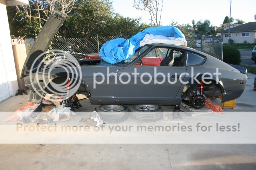

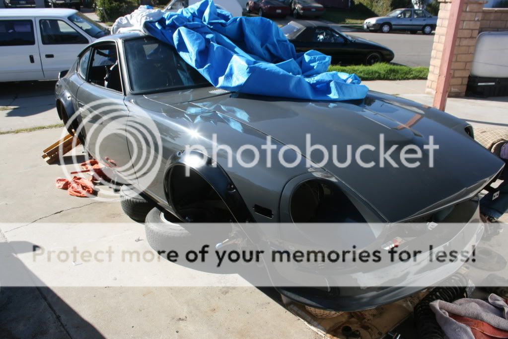

shika805 Posted December 8, 2009 Share Posted December 8, 2009 not yet man =( finally getting my brakes ready to be installed, but this rain is holding me back too. I got my coilovers installed, hopefully by Monday i can get the brakes on also. here is how my set up is looking and current photo of my car. as you can see, still on jack stands Quote Link to comment Share on other sites More sharing options...
Empire Posted December 8, 2009 Share Posted December 8, 2009 Looks great. Is that the grey from the older Audi TT? Quote Link to comment Share on other sites More sharing options...
Rimal310 Posted December 8, 2009 Author Share Posted December 8, 2009 I love that Gray, Audi TT gray right? Quote Link to comment Share on other sites More sharing options...
shika805 Posted December 9, 2009 Share Posted December 9, 2009 yes sir, i went for that color. mine is more of a creamy pearl grey. Quote Link to comment Share on other sites More sharing options...
