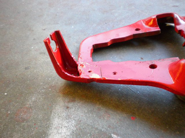

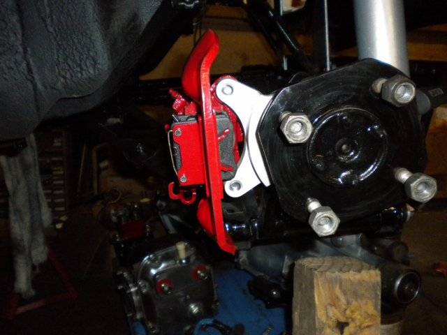

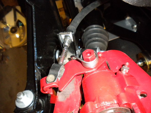

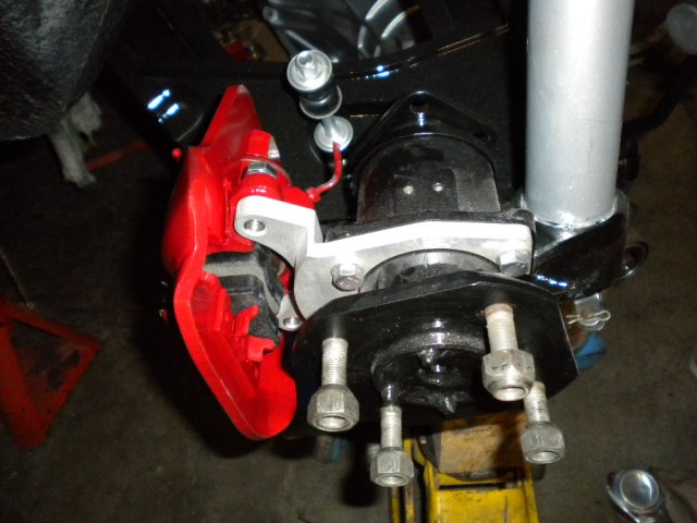

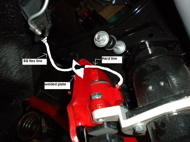

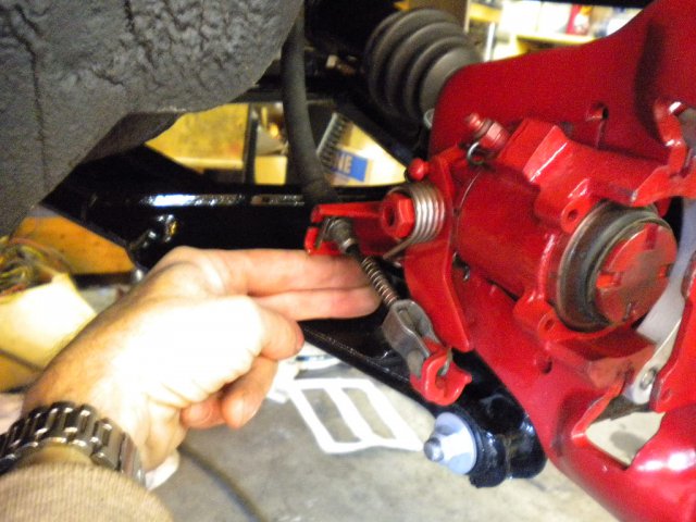

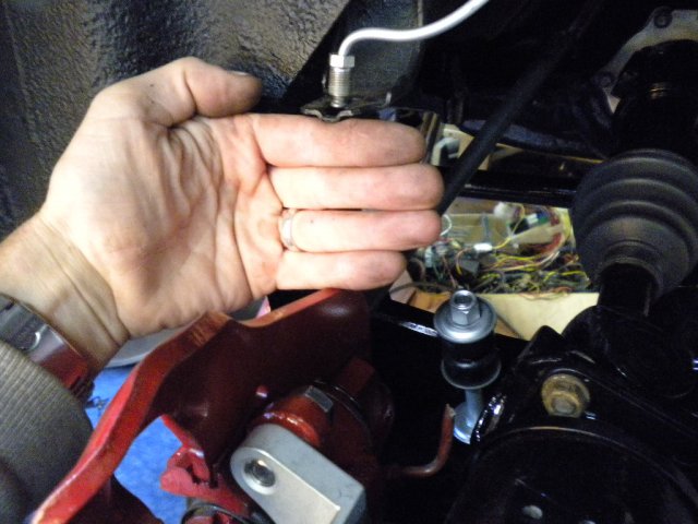

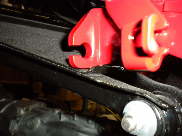

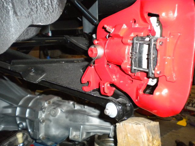

OK, here's what I got. I bought the 79' to 81' 280ZX adaptors and picked up the 79' 280ZX calipers from the Pull-A-Part for $6.50 each (love pull-a-part) pads were $12 for the rears and the adaptor I got for $90 cause someone changed their mind.
Here are the pictures. You can see on the last pic that I obviously need a 90* to aim the line upward towards the main brake line on the body. I'm thinking, maybe a plate weded to the top of the brake bracket to hold the hard line, then the SS flex line from there to the body. Maybe? Opinions?
So do I need to cut off the ebrake bracket and weld on the stock one in that place to get it to correctly and at the correct angle? The cut/bent line is just to keep the inlet clean and dirt free. just temporary.
Dave
OK, so here's what I did.... Took a while but I got the OEM bracket off, loaded the ebarke cable onto the stock bracket and figured out where I wanted it. I went for the old 2 finger spacing and it looks and operates properly. I should have the rotors in by friday and we'll see how they look.
But I still gotta order the stainless lines to mock up the calipers hard lines and see if the banjo is an option or a better bet. Also crossed the E-Brake cables over to take up the slack. I can pull the cable by hand, from in front of the diff, without it binding. So pulling the handle should be very affective.
On the 4th picture, the suspension is fully dropped and when it comes back up, will hit the stock brake bracket. So I need to cut it off and move it back towards the rear of the car so the SS line and the caliper will clear the bracket.
