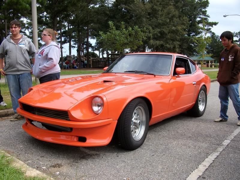

15x8 +4 offest Rota RBs
225/50/15s, had to use a 1/4" spacer in the fronts because the tires hit the spring perch when the car was on the ground. I have tokico 185/200 Springs, HP struts. Car isn't much lower than stock though.
I have plenty of room in the back I'm going to try to go 245s on the back when I get new tires.
