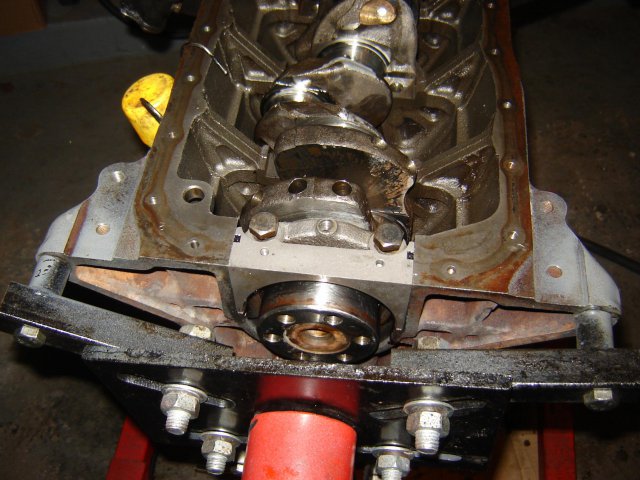

Kash Posted October 24, 2009 Share Posted October 24, 2009 It might be the seals on each side of the rear main bearing cap. Not sure if you could replace those with the engine in the car ... Man don't say soooo....but you may be right because I had a tough time getting those seals in and was afraid that I may have damaged one of them after pounding it in...son of a %!^@#, that's got be it! Quote Link to comment Share on other sites More sharing options...
Kash Posted October 24, 2009 Share Posted October 24, 2009 Here are a few pic's I took during the install: Quote Link to comment Share on other sites More sharing options...
