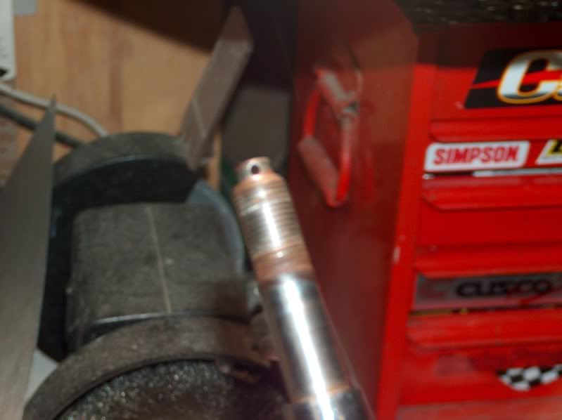

Mayolives Posted November 7, 2009 Share Posted November 7, 2009 I need advice about how to adjust my Koni 8610 red shock absorbers. Each shock has a small wheel on the top end with holes in it. This wheel can be turned with a small straight tool. I use a very small screw driver or one end of a small allen wrench. The adjuster can be turned about 2 1/2 rotations. According to the adjustment procedure from Koni's site as copied below, that single adjustment knob, as they call it, adjusts both rebound and compression. How can this be? When I adjust the knob in a counter clockwise direction, it definitely softens up the suspension and the opposite happens when I adjust clockwise. It would appear that I am only adjusting the rebound and I would like to adjust both the rebound and the compression. The problem I'm trying to cure is a "chattering" or hopping condition of the whole car when exiting a corner at the limit with the hammer down. These shocks are on my road race car and I'm running 350 and 375 lbs coilover springs, MMS rear adjustable arms, AZC front adjustable arms, Quaife differential with the rest of the alignment set at John Coffee's recommendations. I just don't understand how to set both adjustments with only one adjustment knob. I know that I can read but the instructions are as clear as mud. Any advice from someone with an understanding of how they are to be adjusted or what I can try in order to cure the chattering condition would be greatly appreciated. FROM KONI WEB SITE: Adjustment Procedure 8041, 8042, 8241, 8610, 8641, 8742 Series Rebound Adjustment Procedures Externally Adjustable. These dampers can be adjusted, literally at the turn of a knob, a technique borrowed from Formula-1 racing where KONI dampers have dominated the field for years. One can switch back and forth, in most cases in a matter of seconds, from a comfortable "touring" setting to a more firmer setting for a sporty drive. By means of a knob damping forces can be altered to driving conditions or personal preferences. REBOUND ADJUSTMENT DIRECTION Clockwise = Softer Counter Clockwise = Firmer COMPRESSION ADJUSTMENT DIRECTION Clockwise = Firmer Counter Clockwise = Softer Quote Link to comment Share on other sites More sharing options...
DrSideways Posted November 8, 2009 Share Posted November 8, 2009 Tom, These are the same units I have on my car. They are only externally adjustable for rebound. You can get them re-valved from Koni if you send them in. It would be best if you had them dynoed before so you know where you are at. I set mine mine stiffer bit by bit until it quit bouncing going up the back straight @ VIR. I think I am up to #500 in front and #450 in the rear. My notebook is out at the shop. Been a while since I looked at it. Alan Quote Link to comment Share on other sites More sharing options...
Mayolives Posted November 8, 2009 Author Share Posted November 8, 2009 Alan, Good to hear from you and before I go any farther, the z car crowd misses you and your hot rod at East Coast events. Hopefully you will get it together soon and come out to play with us. I have contacted Koni but they have yet to respond and I suspect they will also tell me these shocks are only externally adjustable for rebound, just like you have stated. However, thats not what I barganed for and what I was told when I purchased them from Ross at Modern Motorsports. Where do you suggest I send them to be checked? You stated that you were at #400 and #450. Are you refering to spring weights? My car is balanced very well having nearly identical corner weights with full load and driver in place. In that condition it weighs 2560 lbs. Are you suggesting that I go up on my spring weights? Thanks again for your help. I know that you have ben there, done that. Quote Link to comment Share on other sites More sharing options...
DrSideways Posted November 8, 2009 Share Posted November 8, 2009 Thanks. Maybe sometime next year I can get back to work on it. No real rush right now though. As for the Koni guys I suggest you get in touch with Lee Grimes @ Koni. He posts here some :http://www.roadraceautox.com/ So you might sign up there and PM him. I don't have an email address for him. I am not sure who locally could dyno a strut insert. Some of the Porsche guys may know. Speedwerks in Thomasville, NC may know of a place. Other than that Koni could. Can't say anything about Ross and his items. However I do normally see two adjustment knobs/screws on double adjustable shocks. I think I am at 500# springs in the front and 450# in the back. I just kept going higher until it felt good and the car would hold ride height going through hog pen. My left rear would touch a bit sometimes with a lighter setup. Not really suggesting you go up, just more of a reference for you. I have the slicks so that makes some difference. When I have to go to radials the process begins again.... @ $1900.00 a set. @%&*#!!! Alan Quote Link to comment Share on other sites More sharing options...

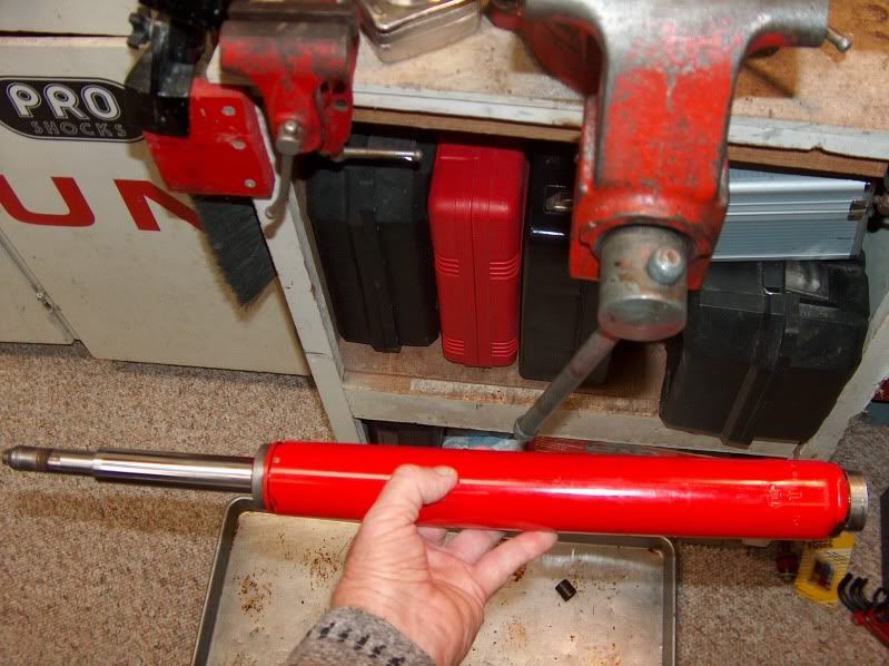

Mayolives Posted November 8, 2009 Author Share Posted November 8, 2009 Adjuster On Top End Ring Tacked On Bottom End For Better Fitment Length Quote Link to comment Share on other sites More sharing options...
