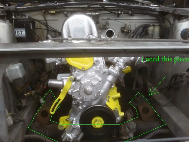

NIIK Posted November 16, 2009 Share Posted November 16, 2009 on my z the part highlighted in green is rusted badly and i notices that it can be unbolted. where would be the best place to get a new one, and do they make aftermarket tubular ones, or would that have to be custom ps this isent my picture i barrowed it from Phlebmaster Quote Link to comment Share on other sites More sharing options...
Sketch_hs Posted November 16, 2009 Share Posted November 16, 2009 The entire subframe and engine mounts? If it's really rusted and has some rot, replace it. If it's just surface rust, brush it off and seal the metal with some good paint or por15 Quote Link to comment Share on other sites More sharing options...
NIIK Posted November 16, 2009 Author Share Posted November 16, 2009 i want to replace it but is the only way to get one from a junk yard cause i cant find any near me that have any z's. even the import only junk yard. Quote Link to comment Share on other sites More sharing options...
blackice280zxt Posted November 16, 2009 Share Posted November 16, 2009 i want to replace it but is the only way to get one from a junk yard cause i cant find any near me that have any z's. even the import only junk yard. you can buy them new but they are pricey. If you want one I can get one for you. But let me know soon! The car is going to be in line for the crusher in the next week! Quote Link to comment Share on other sites More sharing options...
NIIK Posted November 16, 2009 Author Share Posted November 16, 2009 i would love that how much is it i dont have much now as i am closing on a new house but i need the part so ill see what i can do. i have a 78 but i dont know if the year makes a differance Quote Link to comment Share on other sites More sharing options...
Administrators BRAAP Posted November 17, 2009 Administrators Share Posted November 17, 2009 Got your PM, thank you. The '78 cross-member should work just fine. Just curious, why do you want to replace the cross member? Is it broken/bent? Quote Link to comment Share on other sites More sharing options...
NIIK Posted November 17, 2009 Author Share Posted November 17, 2009 It's not bent, but in a way it is broken. It's rusted badly and it is affecting the steering, because i cant tighten the rack in place since the mounting holes where the bolt goes through is rusted off. The structure of it seems good but not the rack mounts. Quote Link to comment Share on other sites More sharing options...
