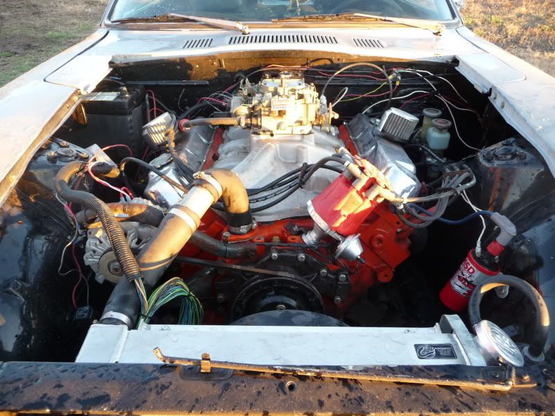

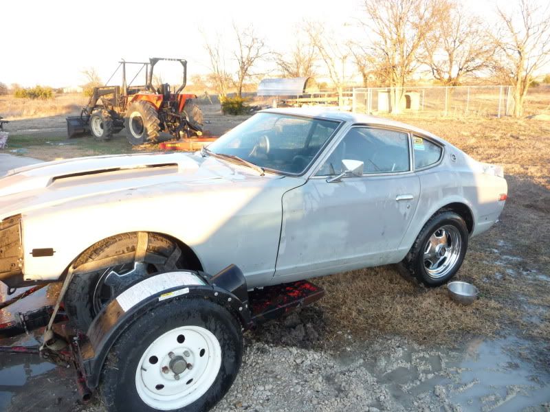

Runnin L8 Posted January 8, 2010 Share Posted January 8, 2010 I mostly post on the Cadillac boards, but recently picked up this Z from Oklahoma. I didn't do any of the work you see here, other than re-stab the dist. and some minor oil pump changes. The new toy!!! It's a 1971 240Z with unknown origin 5200 Cad Motor. The guy I bought it from thinks it to be a 1970- .030 over 500, but when he bought the car the long block was already assembeld. The first owner installed the motor (long block)/ trans, ehaust, went through the suspension (all new bushings, springs, struts), then sold the car. The guy I bought it from got it to this point. He has driven it, but not much due to bad master cylinder. Then he was deployed (submariner) and it sat for 5yrs. He's going to school now and it was going to sit for another 4yrs so he decided to sell it instead. He made quite a bit of progress on the car and kept almost all his reciepts. Kinda Cool cause it gives me a good idea of what parts are in it. I couldn't figure out how to post an Excel file, so here is the reciept list. I rounded and included shipping costs in the prices. Edel Perform RPM 500 Fuel filter 78 Fuel pump relay 33 fuel pump (Mallory Elec) 241 towing 90 driveshaft 205 title 159 headlights / wiper/misc 101.3 starter 59 Alternator 49 Fuel Reg 75 vlv cover blt 29 rad cap 40 fan relay 60 over flow can 15 misc fuel fitting 67 Lockar trans kick down 58 10 galcell 175 Edel performer with kit 270 trans filter 7 Thrt brkt 20 Thrt cable 29 trans cooler kit 20 trans cooler 160 oil adapter 32 rad hose / exhaust gask 33 misc clamp / elec 26 exh coll gask 22 Oil / misc clamp 16 starter sol 32 batery / fus 47 starter sol / oil filter 38 ball joint 25 shoe 411 168 slotted rotors/ race pads 241 240 conversion manual 39 blts 8 Painless harness 328 lock ties 15 exhaust wrap 42 Autometer Volt 38 boot pro race 23 fuel line 100 exhaust wrap 43 starter shield 24 be cool rad kit 734 msd dist 330 8.5 msd wires 80 msd 6A 200 autometer oil 42 autometer temp 69 Oil kit 46 valve cover bolt kit 28 temp send 30 misc brckt 50 cad guide 10 mt10/lifters/spring/retain/misc 503 American Rac. Wheel 700 $6,702 I'm really excited about the car. I always wanted to do this swap, but this puts me way ahead. I'll be rear mounting a pair of T-60's latter this year on a differnt low comp Caddy motor. It'll be on E-85. I'm also planning to swap over to a Dana 60. In the mean time, I'm just gonna keep smoking the tires:rockon: Quote Link to comment Share on other sites More sharing options...

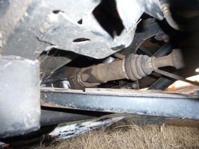

RB26powered74zcar Posted January 8, 2010 Share Posted January 8, 2010 lol... that poor R180 ain't going to last but a minute with that torque monster. Have fun with it though!! Quote Link to comment Share on other sites More sharing options...

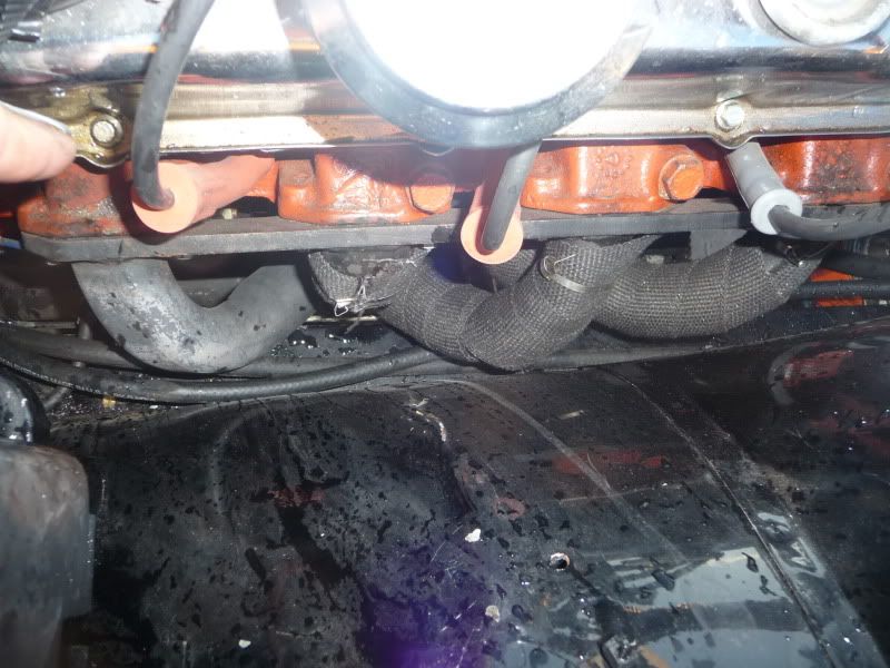

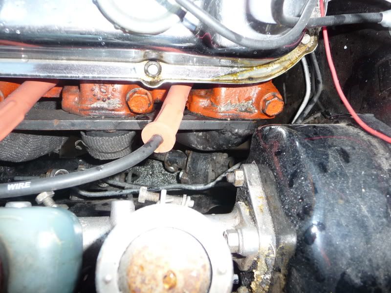

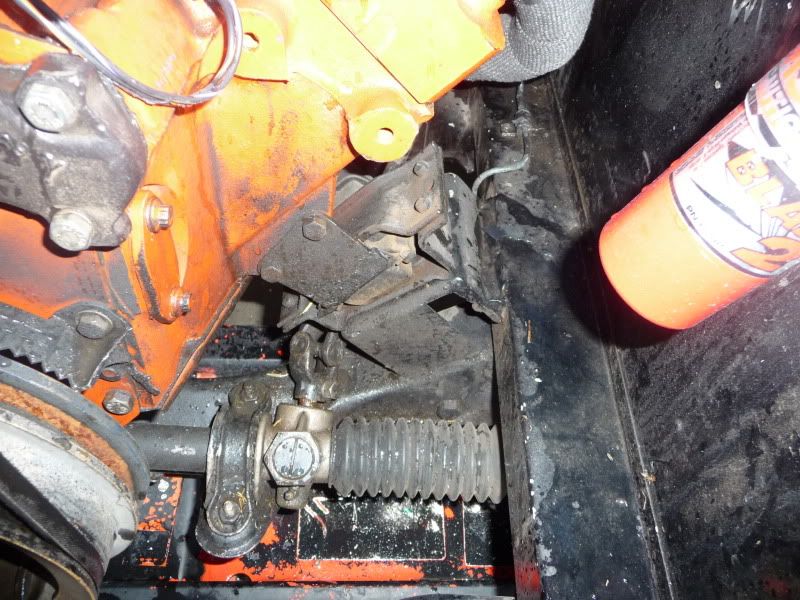

Dan Juday Posted January 8, 2010 Share Posted January 8, 2010 Steering coupler to header clearance is a little tiiiiiiiiiiiiight! Quote Link to comment Share on other sites More sharing options...

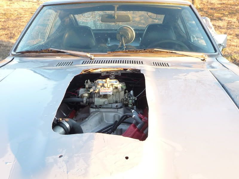

Dudeboy Posted January 8, 2010 Share Posted January 8, 2010 I like It !!!! If I ever have a little bit of money, I want to build one. Second, hold on to the hood scoop, they are very hard to find !!!! Quote Link to comment Share on other sites More sharing options...
Runnin L8 Posted January 10, 2010 Author Share Posted January 10, 2010 Thanks guys:2thumbs: The car is a blast to drive. Dudeboy - I do like the hood scoop. What do they come off of? Dan - that's just how I like it. : ) Quote Link to comment Share on other sites More sharing options...
Dan Juday Posted January 10, 2010 Share Posted January 10, 2010 Dudeboy - I do like the hood scoop. What do they come off of? ... It's actually a factory Nissan part. It was a quick fix when excessive under hood temperatures caused vapor lock. Dan - that's just how I like it. : ) Keep an eye on the bushing. Hot headers melt rubber! Quote Link to comment Share on other sites More sharing options...
Blustriker Posted January 10, 2010 Share Posted January 10, 2010 Wow... Amazing.. Very cool man... Good luck keep updating.. i wanna see how it comes out. Quote Link to comment Share on other sites More sharing options...
Runnin L8 Posted January 10, 2010 Author Share Posted January 10, 2010 "Keep an eye on the bushing. Hot headers melt rubber!" Will do. Do they make a replacement that is less prone to melting? Quote Link to comment Share on other sites More sharing options...
Rustyfriend Posted January 10, 2010 Share Posted January 10, 2010 I'm sure it wouldn't be too hard to machine one out of aluminum, but I wonder what that would do to vibrations in the wheel... Quote Link to comment Share on other sites More sharing options...
Dan Juday Posted January 10, 2010 Share Posted January 10, 2010 "Keep an eye on the bushing. Hot headers melt rubber!" Will do. Do they make a replacement that is less prone to melting? I would cover it with header wrap, or maybe just aluminum foil. Most of the heat will be radiant so some sort of reflective foil should do the trick. Quote Link to comment Share on other sites More sharing options...

smokeybear Posted January 21, 2010 Share Posted January 21, 2010 I'm sure it wouldn't be too hard to machine one out of aluminum, but I wonder what that would do to vibrations in the wheel... I am pretty sure they sell aluminum ones online, I can't remember where but I know I have seen them on ebay once or twice. Quote Link to comment Share on other sites More sharing options...
