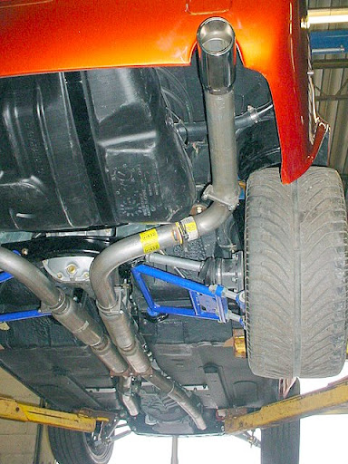

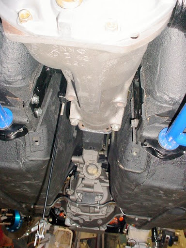

boyracer Posted March 13, 2010 Share Posted March 13, 2010 On 2/22/2010 at 10:48 PM, palosfv3 said: The first pic shows the slight modification we made to the trans bracket. We modified the angle of the bracket to parallel the outer edges of the tunnel. Takes about an hour or so but worth the effort. This will allow you to get the exhaust pipes to fit nicer in the space . Dont beat the floor in . You will make the job of bending the front pipes more difficult. Love the exhaust install , what gas tank is that? Are those glasspacks? Quote Link to comment Share on other sites More sharing options...
