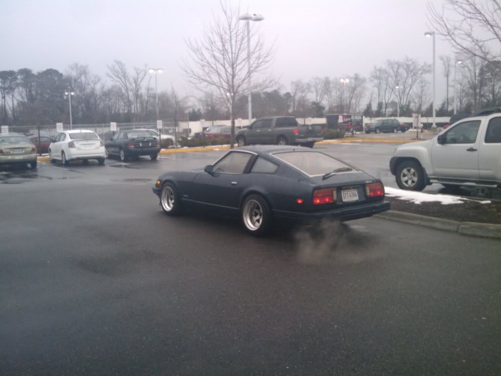

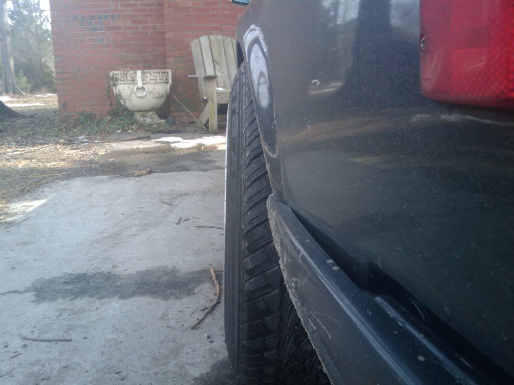

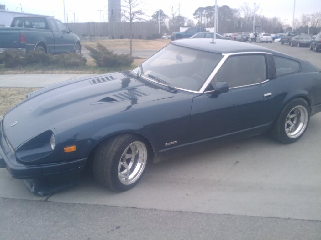

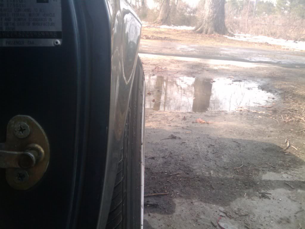

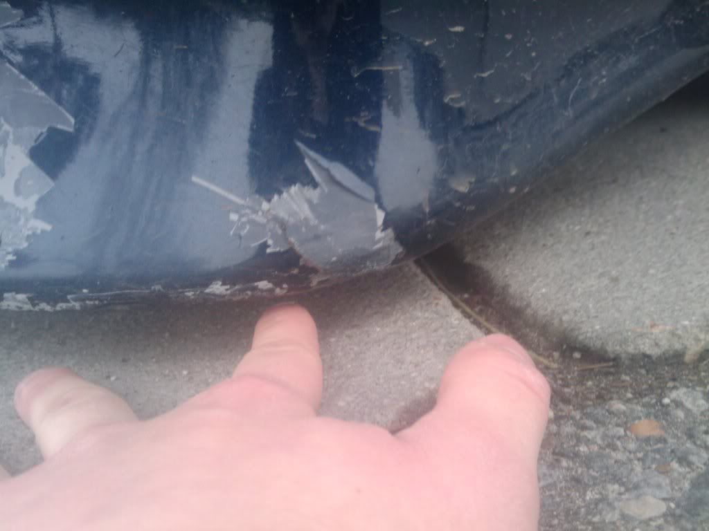

KnightoftheRound Posted February 5, 2010 Share Posted February 5, 2010 Yeah, theres some pretty bad stuff here too. It is just OEM replacement KYB shocks with cut stock springs. 3 coils front, 2 rear. Wasn't concerned with performance really, just looks, which sounds dumb because I went through the trouble of rebuilding an L28ET and swapping one in, then doing the Z31 ECU swap. For a side note, I am very surprised at how much power the stock L28 can make, all I have is the Z31 swap, stock down and mid section of exhaust with a 2.5 shop job after that, a Isuzu front mount, stock ass boost, and air intake to accommodate the new MAF setup, and it will easily spin first and sometimes second on a cool night. I need an LSD to stop roasting single tires LOL Here are some more pics I took today of the fitment: And this is why lowering it any more would be a bad idea: There are WAY more places in Virginia Beach with inclines like this than there should be >____< You can see how I have only a finger sized gap between the air dam and street going down that incline, most places don't have that wide of an opening, or you have to worry about traffic coming in, and blocking the whole way. Quote Link to comment Share on other sites More sharing options...
