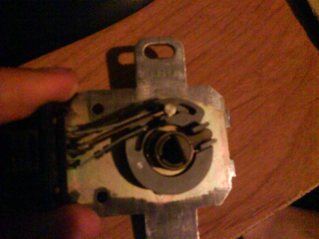

Hyuri Posted February 8, 2010 Share Posted February 8, 2010 I believe the shaft is keyed one way, I know the TPS is (see picture), and I don't think the wire would reach the bottom anyway. Quote Link to comment Share on other sites More sharing options...
